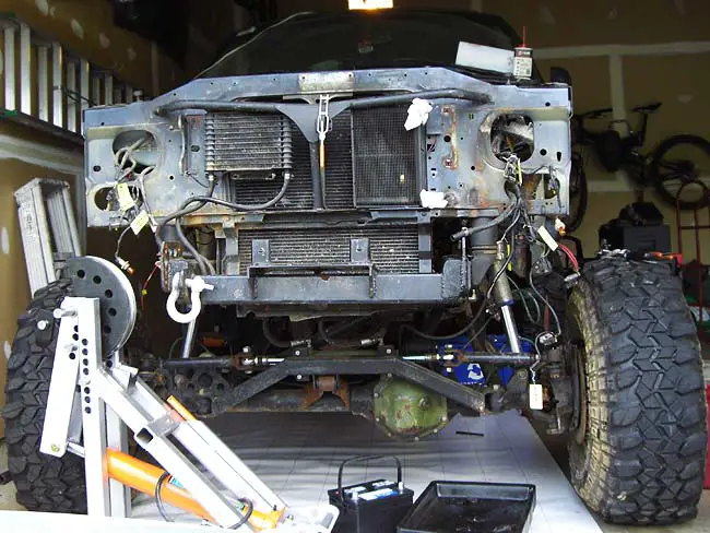

Spent a little bit with the Explorer today -- began stripping the front and some of the interior (the hydraulics and the winch stuff).
And started to label everything I disconnect.
The Plan For The Front
The plan, beside the cage doodad, is to move the engine/trans/transfer case back maybe 6". This will require tucking the engine into the firewall so the body will have to be cut and a new tunnel made. The dash will go away and I'll probably bend up some aluminum as replacement. Part of the new tunnel will be removable for transmission access so the body lift will be either removed or chopped down to 1" or whatever.
With the engine moved back, the rest of the chassis in front of the engine mount will get chopped. The front axle centerline will also move forward a few inches (maybe 3"?) which should allow the front axle to come way up into where the chassis used to be - and in front of the moved engine. This will also allow a really high and horizontal panhard bar for better roll center.
The body will probably be boat-sided with 1/4" plate for the feel-good gliding over obstacles sessions.
As for the back, well that comes later :). But the overall goal is to keep the vehicle really low to minimize roll.
