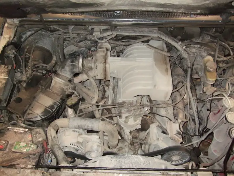

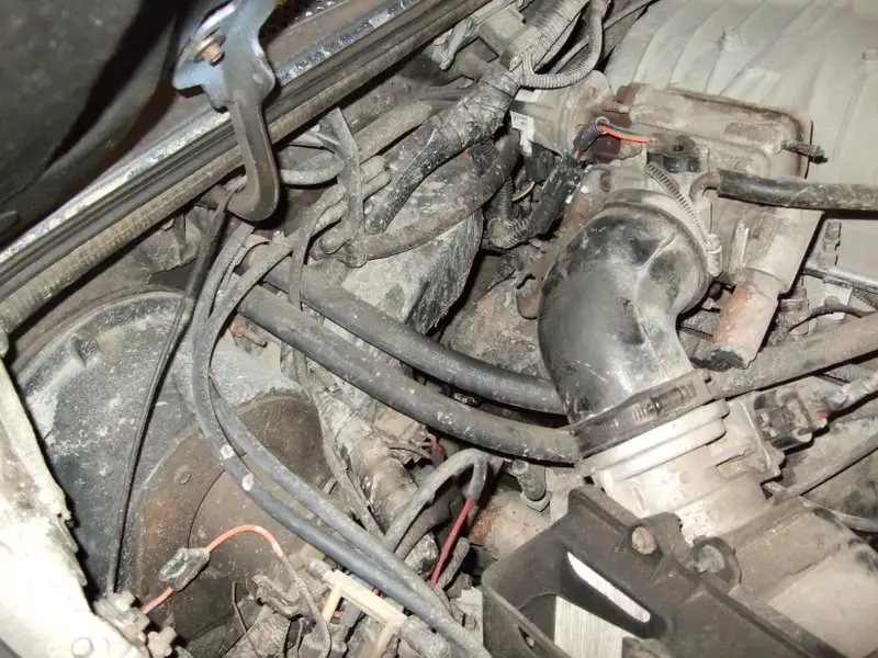

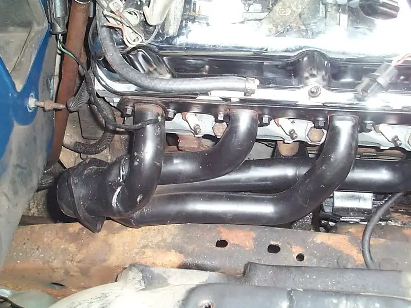

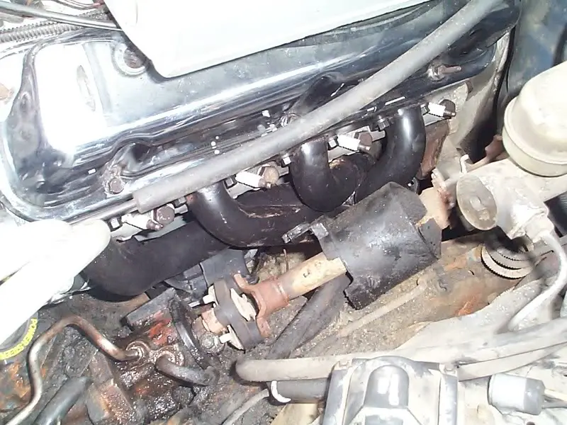

I got rid of my A/C blower motor plenum and replaced it with a non A/C plenum from a ranger with makes tons of access on the passenger side. On the drivers side, the #7 plug is not difficult to get at, just takes a little patience because of the dipstick and steering shaft all there. The #8 plug, I have to use a wrench on the end of my plug socket because there isn't enough room for a ratchet on the socket because of the firewall. Make sure you put your headers on good before you install engine though as this is a royal PITA to re&re on the drivers side.
Non A/C plenum - Lots of room
Engine Compartment
Drivers Exhaust
