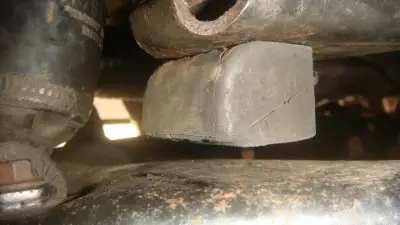

Depends on the style you're looking for. Lots of them on Ebay with really good prices, do a search. You reminded me to cut my front bump stops. I haven't been using them since I lowered, and recently heard popping noises from my shocks bottoming out over large bumps. Found out the torsion bars sagged about 3/8" over the years. Used a hack saw and oil to remove about 1/2" off the bottom. Didn't want to cut more because there is metal hidden underneath the rubber. Problem solved, even steep bumps.

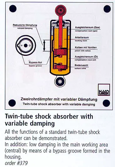

The Sensatrac's have a center band of "reduced" damping, that is some 1" in size. That's their Position Sensitive Damping to enhance comfort. It was invented a long time ago, before multi-valving and monotubes.
In your case you are out of that band, the shocks are acting just as cheap Eco-Matic Monroe's now.
Until you hit a deep hole and then, the travel reaches the part with loose damping and when you need the most control... you don't have it.
