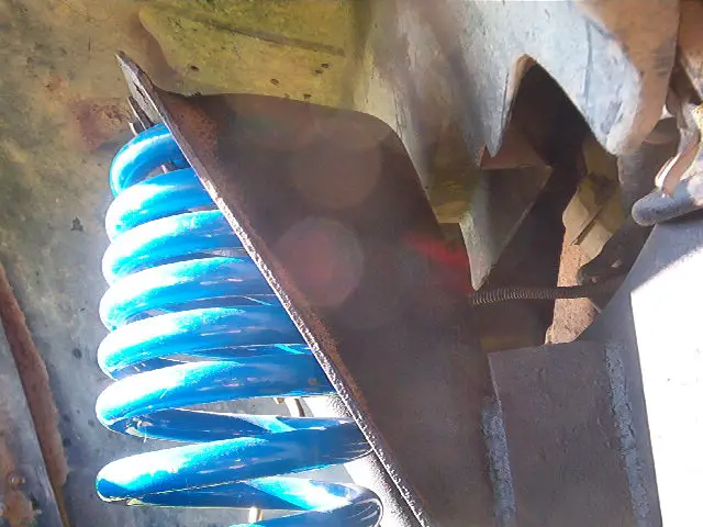

I have a superlift Adj.tracbar for a 78 f-150 on the way, I am currently using a stock f-150 tracbar.
My shock mounts(2"),coil buckets(2") & tracbar mount(~1") are all spaced out. and my lower spring retainers are "clocked" for best fit, I am using one of the orignal bolt holes and drilled a new hole.
Should/when it stops raining here in WA I will get you some pics of what has worked for me.
The coil buckets off the 78 f-150 are not flat like what appears in the photos of the EB coil buckets I have seen, and move the coils out about 1". here is a couple pics of my buckets from awhile back.

did you grab your axles off a f150 or bronco? I was planning on geting the superlift adjustable trac bar for the 78-79 bronco, since my axles are off a bronco!!
When the bronco went full size in 78 it used the f-150 suspension, So I would assume they are the same.
I bought a whole donor vehicle(78 f-150 w/ 4" lift) and took what I wanted, stripped off what I could sell and then called the hulk hauler.
Thats good to know information. What year(s) of F150 did it use the suspensions on? I can keep an eye out for these years of F150 when I do the shopping.
I basically did the same thing to my donor bronco. Ripped out evreything I wanted, helped my friend take out what he wanted, and got rid of the bronco. What kind of tires you planning on running?
I am not sure of the exact year of change I think it is 76-79
