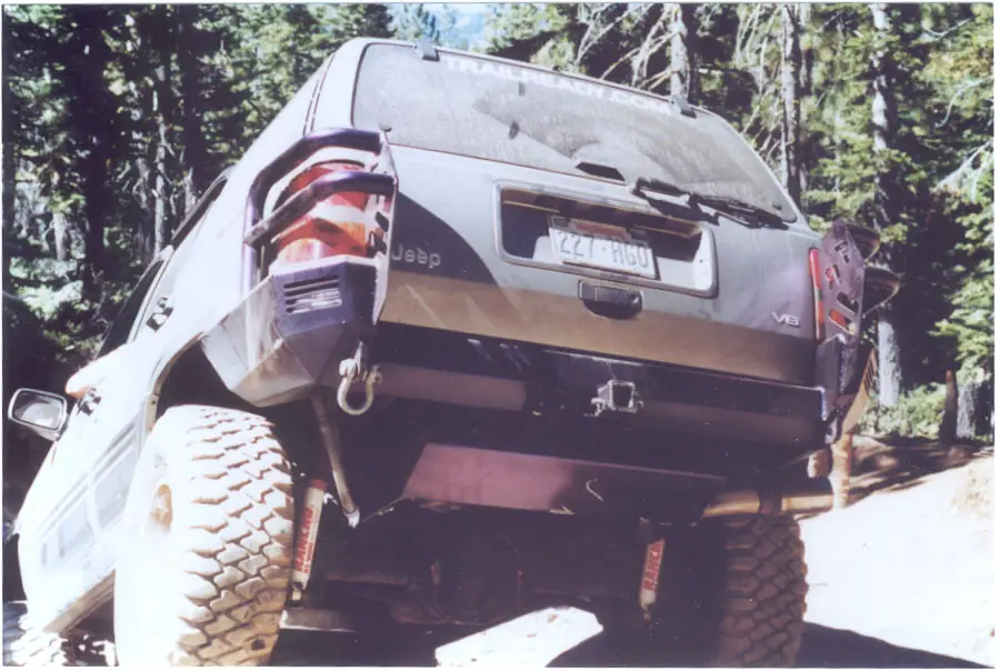

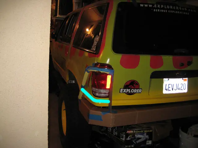

Call me crazy, but I just thought of an idea while looking at Aric's truck. Would it be feasible to build a light protector cage thing off of the tailgate instead of the bumper, so that with the hatch open you can remove the lights to replace a bulb or whatever? I don't know if the hatch even has enough structural integrity to support any large impact. :dunno: Just a thought.
It need to be a part of the bumper, there is not enough strength anywhere else. Yes it will be a pain, to remove the bumper to change lights, but maybe I'll go LED and solve that:D
The whole idea is to make it so you can add a tire gate;)

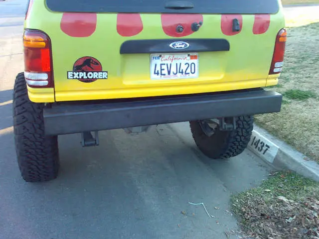

can i get some measurement on that bumper
5"x5" x3/16 Main piece is 60" then just weld the 5"x5" on the ends;) Dosn't get any simpler:thumbsup:
note: however the body sits about 1/2" different from one side of the frame...weird:confused:

How is this coming? I'm making mine pretty much the same but skipping on the light protection.
I like!, are you going to add any kinda tire carrier to it?
Spare has to stay in the truck for now. I have 4" or so longer I can make the truck before it dosn't fit in the garage anymore.:( But it will be disgned like the above for two reasons.
1. Side protection
2. With the flat piece on both side I can easily weld in a spare tire gate with a douple hinge at a later date;) (when we move again, hopefully next fall and buy a house)
The reasons for the guards is more then just protecting the lights. The other reason is to set it up to build a spare tire gate again in the future. I can put the tire back on the back because of my garage is too small:(

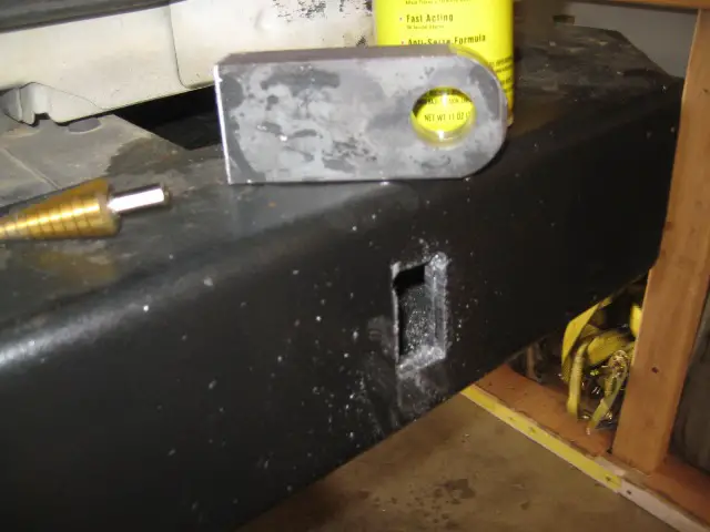

Well, I decided with a run coming up, I should get those rear recovery point finally put in after all these years:rolleyes:
So here they are. A few hours of drilling and sawzall work and now just need to weld them up:D Going through two pieces of 3/16" was fun.
