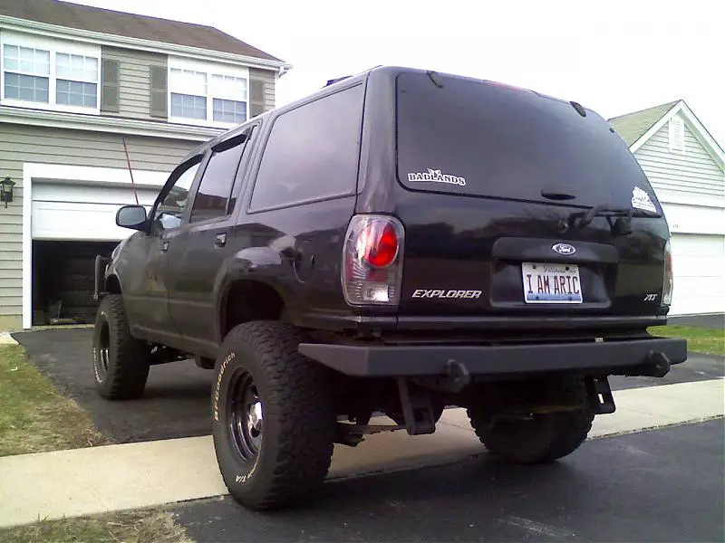

got the main part of the bumper done today. it's held on by 6) 1/2 bolts on the original frame bumper mounts. (2each side and one from the bottom) and then 4) 7/16" bolts on the side braces that use 2 other factory holes in the frame. weights about 90lbs. Total cost of bumper is about $125:D
Still left to do is install tow hooks, like the ones from the front bumper, and may put a reciver in the middle.
I would think you might want to re-enforce the mounts to the frame? They look kinda thin ish.. ??
What about putting more mounts in the back? (is there room?) Make it more collision resistant? lol
Just my opinion n whatnot, constructive criticism. I still think it looks nice either way. It has a good professional look.

If it gets any more colision resistant he will need to renforce the frame at the center hump and the dogleg so the chassis dosn't bend. But some diagnal supports from the center and outside to the frame might not be a bad idea.

the supports to the frame are plenty strong enough! They are 1 1/2" Box 3/16" thick. The only reason I put them there is because of, side stregnth. Rebember, the frame is only made of 1/8" steel:rolleyes:

The side supports are going to be more than fine. Mine were cut off because it came off of Chris's truck with a 3" body lift. I never put them back on and have had no problems. Plus, I've never come close to hitting them on anything.

Steve, have you added your tow hooks or tail light guards to your rear bumper yet? It looks great from the photos you've got up, curious if you've completed the project yet; if so, I'd love to see some pics of the finished product!
Havn't had time to touch it. Tow hooks should go in next weekend. Tail light guards will not get done till Fall I'm guessing:rolleyes: I need to bend some tube up first. Have the tube, just no bender:(

my rear bumper looks like this until you come up with some sweet ass tail light guard designs. :D
i was looking into that zj design with the plate coming up from the bumper and the tubes coming off that and its going to be tight if you want to avoid hanging up on the tailgate and not cover the lights too much. were you thinking like 1/2" tube or something? plus our tailights are a little bit higher and i'm trying to cover up my body lift.... so i have 2 more inches to try and cover than you do.

My plan is 3/16" flat plate running up the out sides of the lift gate and 1 1/2" tube for the bars. yes it will block some of the lights, but they are big enough, it should be fine;)
