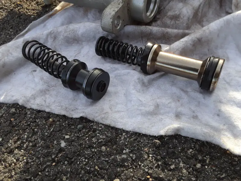

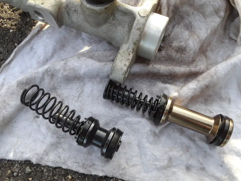

I also took apart the old m/c, and cleaned everything up. Looked at the seals, but didn't notice any wear and tear or cracking, splitting, fraying, or anything. I know probably doesn't mean **** if I can't see it doesn't mean it's not fugged up. Some pics of the old m/c apart. Inside also looks free of any scrapes, scratches or dirt or anything.
You’re losing pressure somewhere. Air wouldn’t compress and give a good pedal, and go away. As far as I can tell, you either have a leak, or a bad master cylinder.
I’d want to try something new, and since it’s free, you have nothing to lose. You can keep bleeding the lines, and get no results, or you can try something different. I can’t think of any more options to try.
I also took apart the old m/c, and cleaned everything up. Looked at the seals, but didn't notice any wear and tear or cracking, splitting, fraying, or anything. I know probably doesn't mean **** if I can't see it doesn't mean it's not fugged up. Some pics of the old m/c apart. Inside also looks free of any scrapes, scratches or dirt or anything. (Oops I meant to post this a couple hours ago... Apparently I never did!
Anyway.. I put the old m/c back together, bled it, then installed it. Way more pedal resistance when key is off... And with car on, it only takes 2 or 3 pumps of the pedal and it builds enough pressure to stop the car really well. I'll bleed all 4 calipers again, and if no change I'll buy a new, top of the line m/c and put that in.
