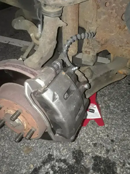

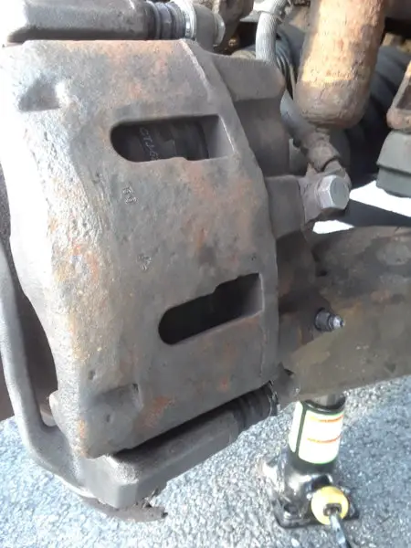

Can you take pictures of each caliper (or at least the front) including bleeder screw? I feel that if you still don't have a pedal you very well could have a miss installed caliper.
I'll do this right after work tomorrow. Not feeling well today. I'm actually hoping I put them on wrong... Would be easy fix :) If they are on backwards, then the parts store I got them from had them in the wrong boxes, or their computer description is wrong. It said drivers side caliper on my receipt had $40 core charge, while the other 3 had $20. So I matched the #'s from the receipt to the ones on the box and put that one on the driver's side. We'll see tomorrow!

Welp... From what you're saying and by looking at the drivers side caliper..... They're on backwards..?
I'll check the passenger side too but I'm pretty sure it's the same.
This would cause pedal to go to floor with little resistance?
As mentioned earlier, the bleeder HAS to be at the top. You will never get the air out of them at the bottom.
Gotta be tons of air, especially in the upper piston.

Absolutely.... I'll switch them and report back... Will do it in about an hour or 2.
Not as uncommon as one would think. Happens when both calipers are removed at the same time, makes a core deposit unnecessary, or to save a trip for core credit. 99.9% it's the issue. BTDT. :banghead:

Oh man! Yes the bleeder valve ALWAYS has to be on the top or you'll never get the air out. It only took 84 posts to figure this one out. Like they say, a picture's worth a thousand words...

Haven't switched the calipers yet, but yes haha I have jackstands... Was just taking tire off to take the picture. I use jackstands and I chock the other tires.
And just for the record... I did 1 caliper at a time, and made sure to do the one that was a $40 core charge...which they said was the drivers side....maybe they were switched in the boxes idk. But I should have known when I was asked if the valves were on top or not once installed... I wasted alot of time and energy trying to bleed the system. Assuming when I switch them it fixes it that is. Just glad Boomin asked for pictures... :)

I switched the calipers, and also installed speed bleeders on them. So once they were switched, all I did was attach a rubber hose with one end on the bleeder, the other in an empty bottle, opened the bleeder valve, and then pressed the brake pedal a few times to get that air out. After closing the bleeder and pressing the pedal, it actually built up pressure FINALLY. (for ppl reading this thread with similar issues)
Again, thanks everyone. Pics of the caliper correctly installed. (notice the jackstand :) )
Edit: The brakes (braking system) works like a charm now. Car stops like it's supposed to :). Pedal might be a bit spongy but it seems minor after MONTHS of either no brakes or very little. Again, thanks everyone! :)
