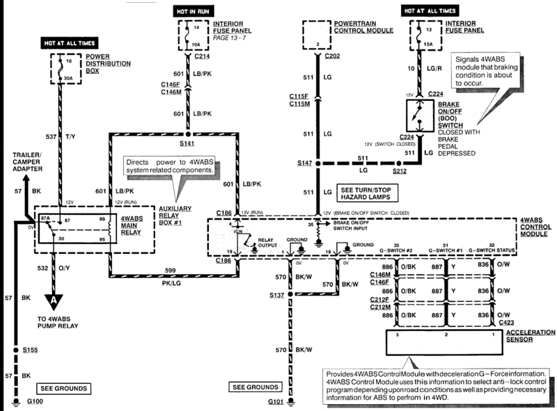

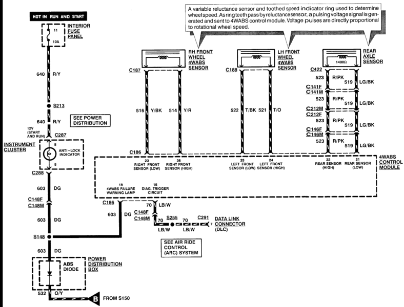

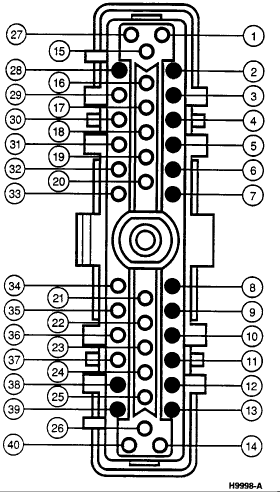

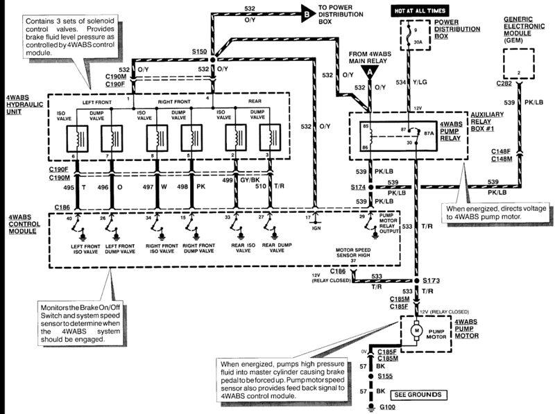

OK, so I have some info, but your going to have to decipher some of this yourself.
The 40 pin connector is located under the Aux relay box #1 at the front Dr side fender as shown in the diagram below.
The connector and the pin outs:
So after disconnecting this, find the pins, and do the ground method as previously posted.
The circuit diagrams to follow at your own risk :D
Anybody want to help with this, by all means speak out!
