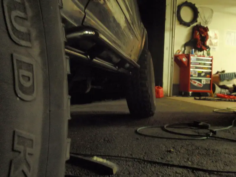

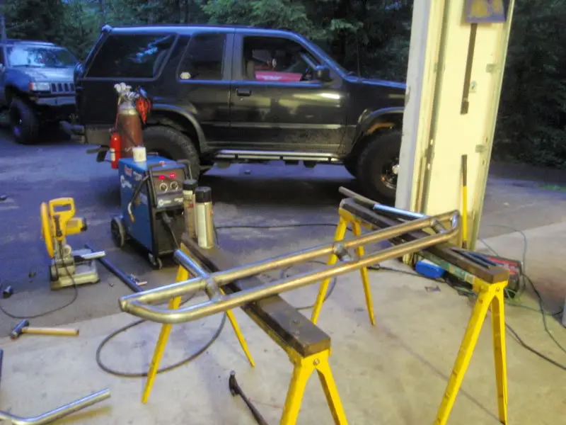

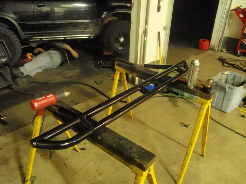

Well Stolle came by this weekend and we fabbed up some sliders for his 97 Exploder Sport. They are made outta 1.75" HREW tubing. I welded 3/16" plates onto the frame to mount the "outriggers" to. Way too much beer was consumed in the process but overall it was a great success:D Before I forget Stole, connect that ground strap back up between the body mount under the driver's door and the body. Anyhow, I'll let the pics do the rest of the talking;)
Endless notching...
I'm sure Stolle will post some nice daylight pics soon. If there was more time some dimple dies would have got thrown on but maybe next time:cool:

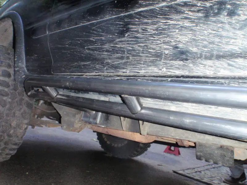

Yah his rig has a 3" BL. The outrigger tubes were fairly perpendicular to the frame actually, we just opted to have the main portion of the sliders angle up with the body lines for some more protection and a better looking product:)
Throw up a couple pics when you get a chance Stolle, I'd like to see what they look like in the daylight seeing as how we finished up at 11pm:D
