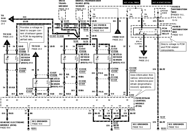

WOW, thanks for the link, where on earth did you find that??? I was just looking for it, found my own post, and found your link LOL:p: I am now removing the center console. I want to have a look at that wiring harness. any schematics for this next part would be tremendously helpful.
This one?
Someone let me know if I was not supposed to post this. I will remove it immediately if it wasn't supposed to be posted.
This one?
just got finished with supper, thanks for the diagram, this is exactly what I needed.

ok, so I got the panel off, found like another $5.00 in change, but I cannot get the wire loom to come out far enough to see, or work with, looks like I may have to drop the tranny, and pull the front tires at the shop tomorrow.

First off, I have no idea what circuit test z is, next the engine will not stay at 2000 at all, I get it close and it jumps to 2500, i let off "big toe control" and it drops to 1100. Seriously, this thing will not stay at 2000. No DTC's, not even p0135, which happens if I drive and then stop, but only happened twice so far. Still pops and poops at around 2500 though, if the rpms go up more,less misfires, and the higher it goes, the better she runs. I wonder if it is because she can breathe better now that the flowmaster is on there? Don't judge me, it was cheaper than the one from the book for my sploder, and he had it in stock I paid 1k just for the damned cats out the door, so realistically it seemed like a heckuvah deal. It has to be the o2, or the circuit, If I can just probe the lines I can figure out what is up. I need to test from the connector to the PCM, on the signal line, test for good ground, and make sure 12v+ is going in for the heater and the sensor.
