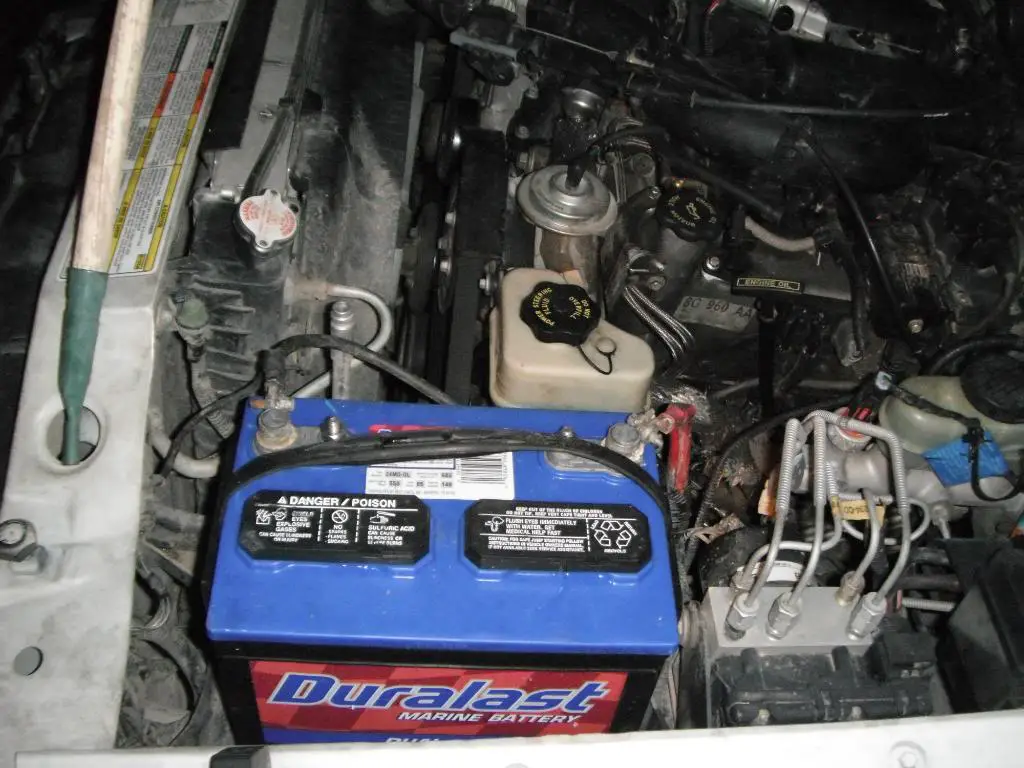

adding a new ground

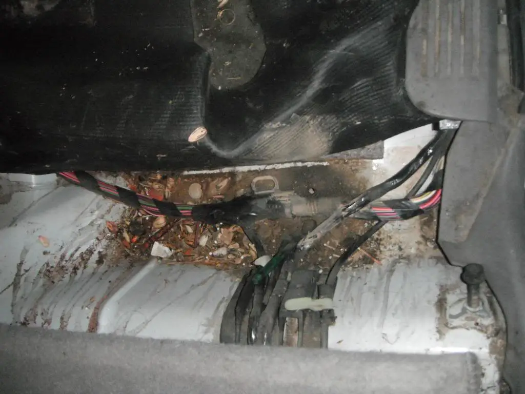

my new injector connectors, don't hate

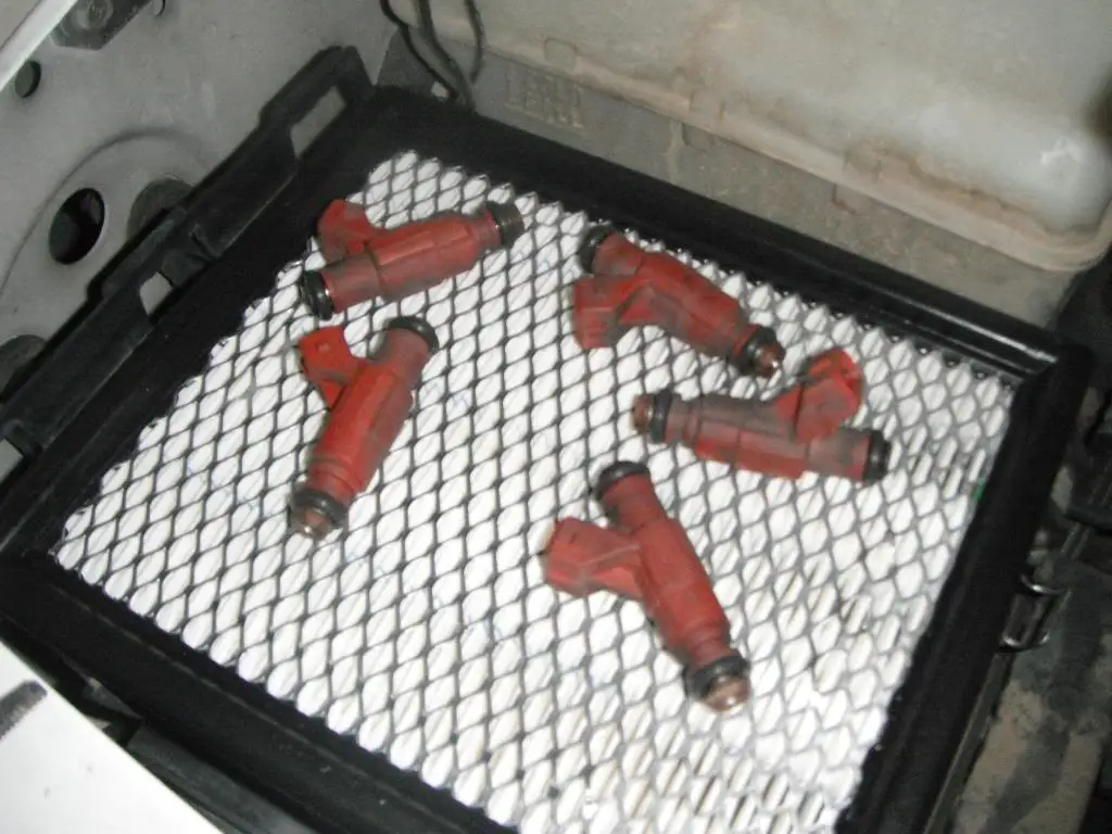

new "well new to me anyhow" injectors

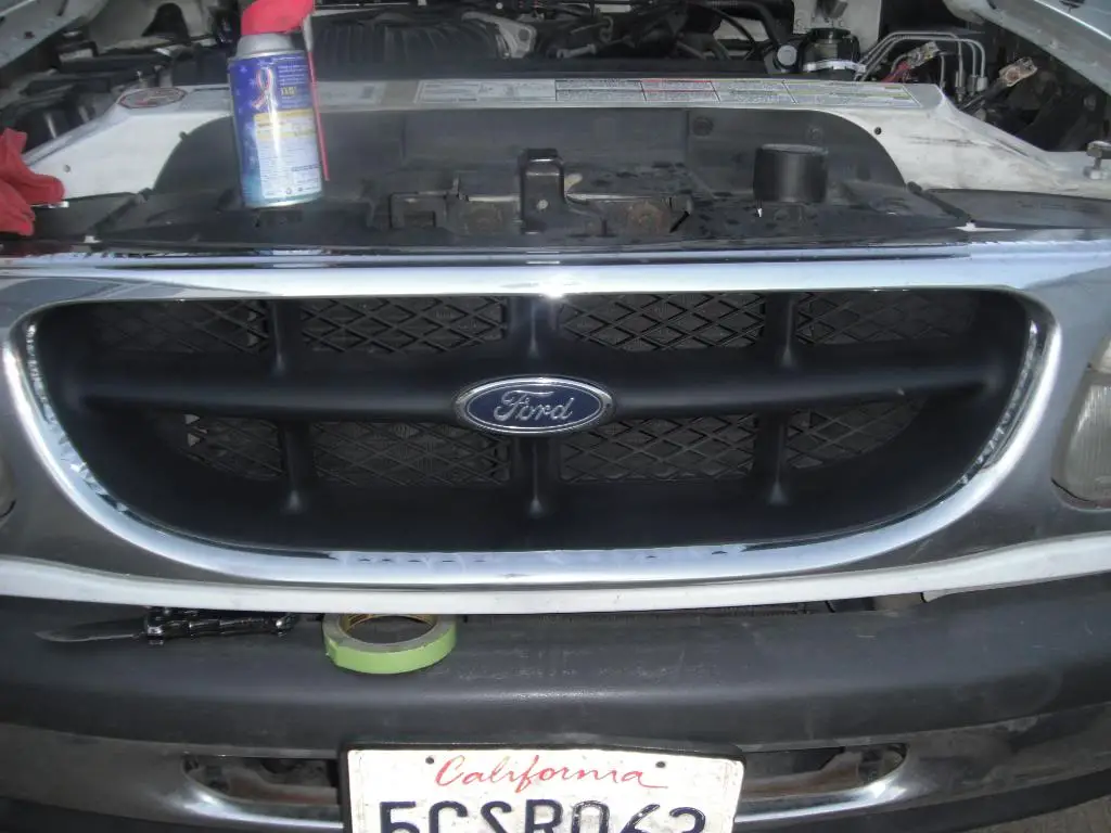

painted my front grille, now doesn't look like a leper

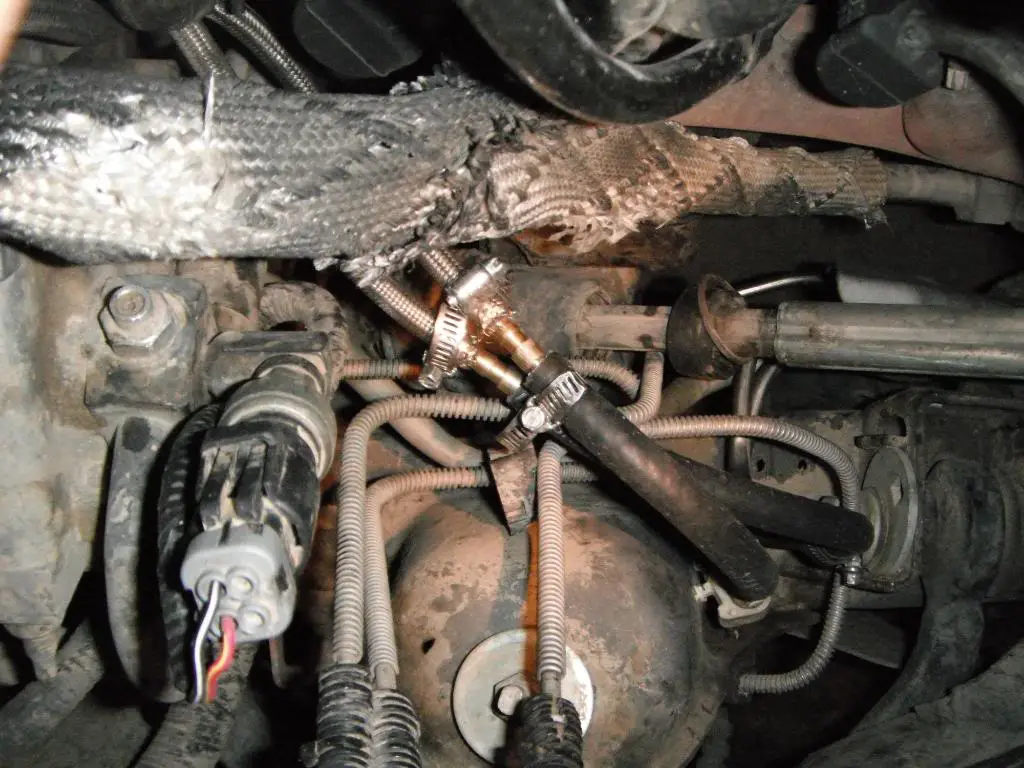

ghetto fabulous fuel line repair work
