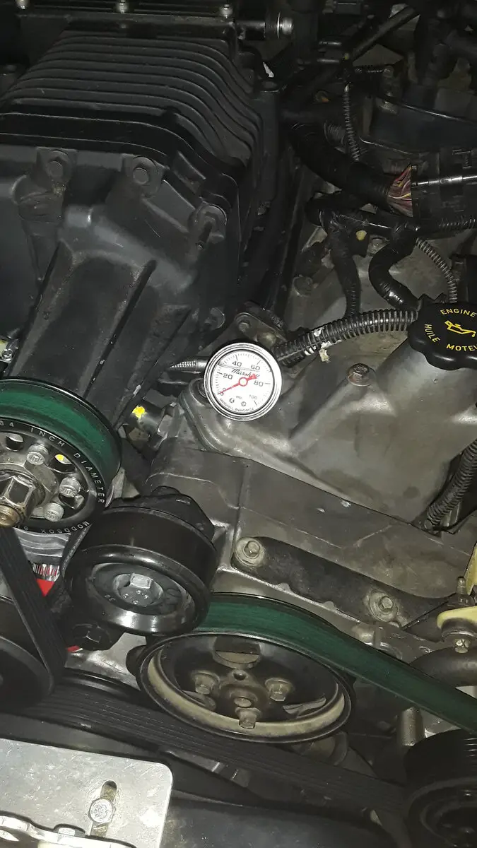

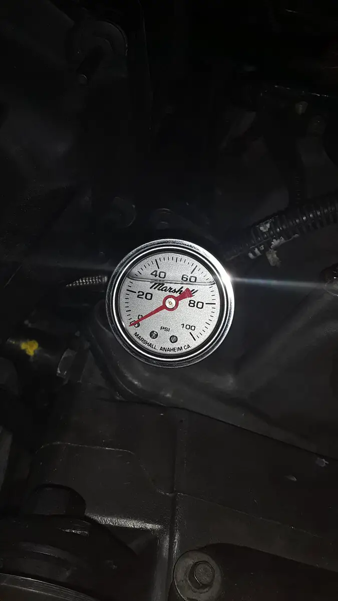

Because fuel pressure is so important
I'm installing this on the fuel rail old school baby
The adapter has a adjustable pin in the middle and a o ring
To depress the schrader valve and seal the thing
Its made of aluminum
I also used thread sealant for good measure
I bought the gauge from amazon

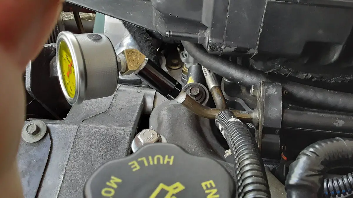

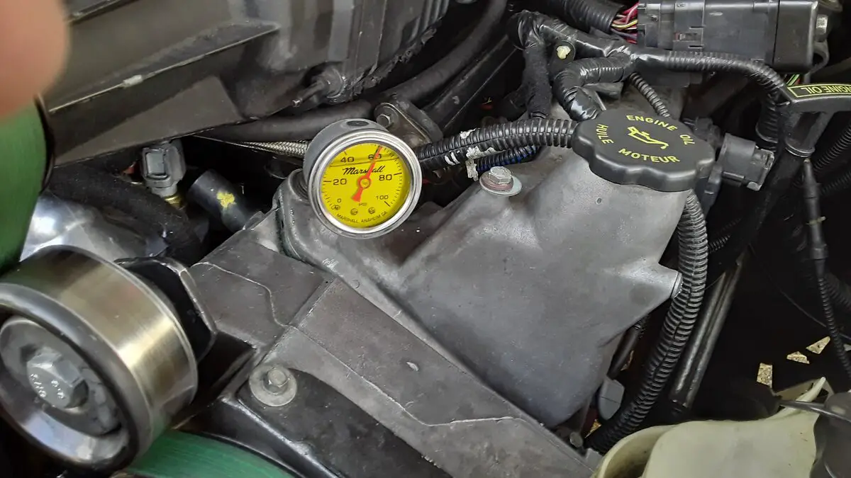

Ok update on the fuel pressure gauge
The gauge leaked because it wasn't level
I did not want to change it much so I used A 45° brass fitting
After it was level i vented the gauge for more accurate reading Any time
I also added a yellow tint just in case some break clean hits it
And it looks good to me

What thread sealant did you use for the schrader valve and pressure gauge? Mine was pouring out fuel on both sides of that adapter.
I used GOOD Teflon tape
permatex high temp thread sealant

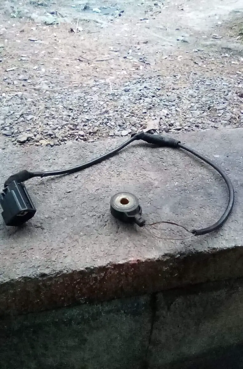

Update
Time for a new knock sensor
Not sure what happened but
After replacing that knock sensor this thing is running better than ever
Watching the sct I'm gaining 10° spark across the board .....give or take depending on throttle
So this is good??
So this is good??
that's never bad to hear :D :D :D
Excellent, more timing is great when it's safe. What was the old knock sensor, OEM, how many miles did it see?
