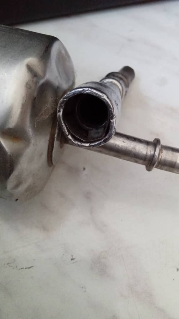

So the original fuel filter fitting on my 2 Explorer were damaged before I got them and fuel filter replacement has been next to impossible. (Even with using the easy disconnect tool as the fittings are already bad).
On one while removing I damaged the already damaged fitting and ripped the pipe. I got a mechanic to swap out the filter and fitting from another car and left a "kink" spot to the point of probably damaging my fuel pump.
On the other Explorer I did manage somehow to replace once or twice but after a stuttering idle and revving I tried to remove, and the clips have become damaged. I also discover the filter is clogged - so on another post I saw folks not wanting to replace the fuel filter - better to do it at least every few years just in case, since the fuel pump on my first one got damaged, mostly likely from a clogged filter.
Coming to my question - is there a fast and easy way to swap out from another Ford or generic off the self - the pipes and holder/fitting and fuel filter to splice onto the original fuel line. As even the 800-063 (from memory) nylon and fitting - which I have bought but not used comes in a pair but are of two different diameters! So really you have to buy 2 "kits" and only use one fitting from each kit.
Thanks in advance.
