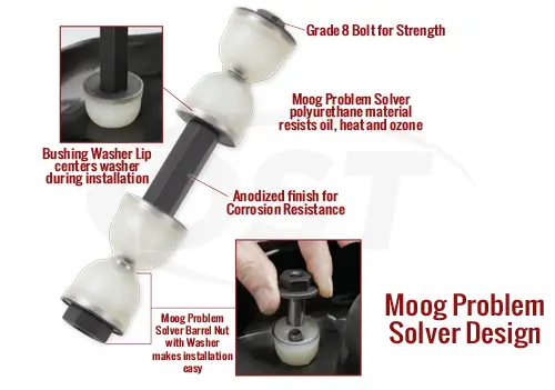

Did you buy endlinks like these for example? Just remove the old ones and put these on. They are the ones I used.
