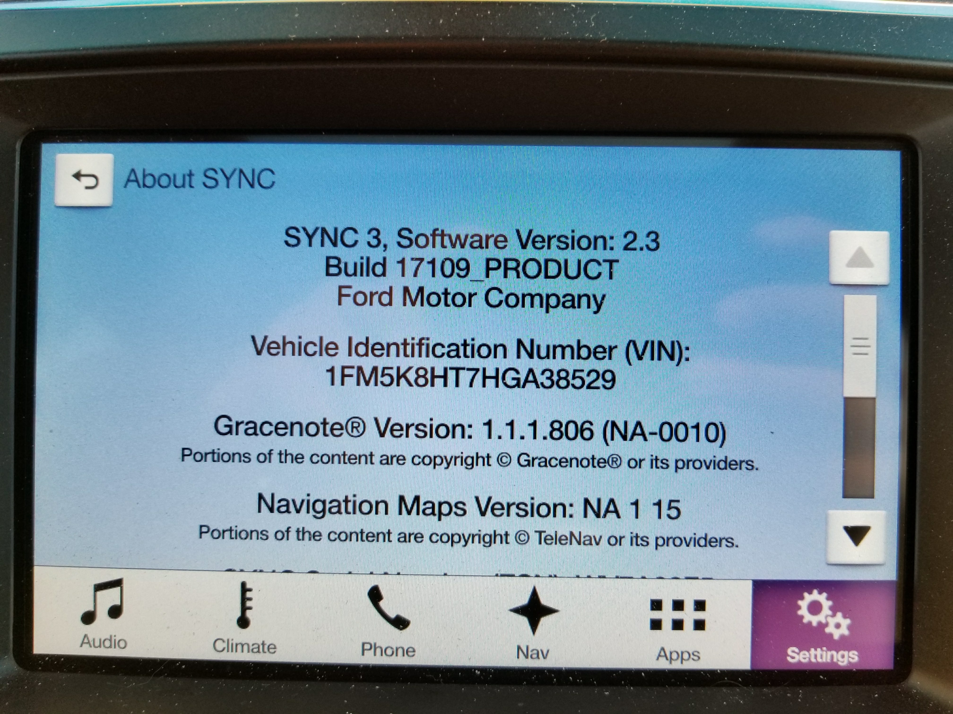

I was update my Sync from 2.2 to 2.3, but i can't download by my VIN (always only have request download and error). I was read forscan important notes forum:
"4. Sync 3 (APIM module) sends its configuration changes to Ford. So if you change something there, Sync will send these changes when connects to the Internet, and after some time you can see them on Motorocraft site. So far there are no known outcomes of this (like loss of warranty), but it is important to known anyway."
Now i check with motocraftservice with my VIN 7D0-xx-xx change same the last configuration, maybe the reason i can't have download link.
I was compared value of 7D0-xx-xx with 2017 canada, 2017 us, 2016 us. Some value like 2017, some value same 2016,
7D0-01-02 x4xx xxxx xxxx NAV: 4=enabled (Sync 2), 2=enabled (Sync 3), 0=disabled (Sync 3)
My Explorer x4xx xxxx xxzz same with 2016. but 2017 us, ca are 7D0-01-02 x2xx xxxx xxxx.
I thing my Sync is last Sync2 upgrage to Sync3 software. In about Sync don't have Navgation Maps Version
