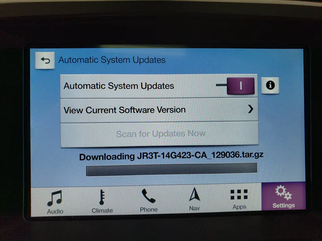

I have a 2018 Sport Explorer and have been having "issues" where the system does not download the updated software that it found .
It has been going on for the last little bit.
Is there something that needs to be updated by the dealership? I am going to be going in this week for my 10k maintenance. Not sure where to find what version I do have installed, the software license menu does show a license name that is similar to what is being downloaded.
Thanks!
I have a 2018 Sport Explorer and have been having "issues" where the system does not download the updated software that it found . It has been going on for the last little bit.
Thanks!
Your thread has been moved to this one in the 2017+ Sync 3 sub forum.
If you go back a page you will find another member with the same problem. As posted, Ford has advised that the ability to download software updates has not been completed yet. At least there seems to be some progress as it is only lately that updates have even been found. Prior to this, it would just keep searching and searching until the user intervened to end it.
As for your current version, just select View Current Soft Version which is just above where it shows Scan for Updates Now on the last screen shot above.
