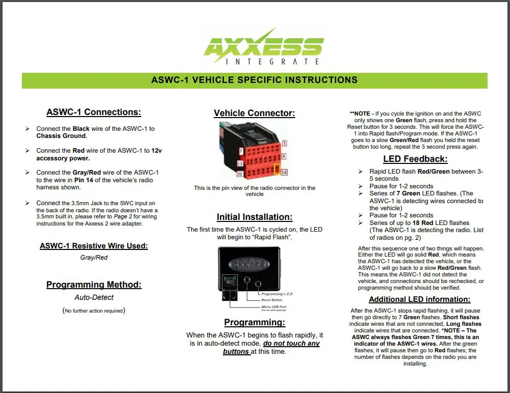

As it is important to retain the stock functions in our vehicles, I don't want to loose the steering wheel controls. :eek:
I did a little research and found this little GEM that can be used with any aftermarket radio. Its as simple as wiring up 3 wires. :bounce:
Axxess Integrate - ASWC-1 - Instructions - Avg $46 Cost

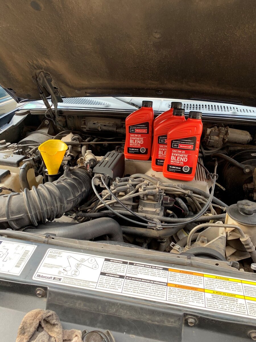

Changed her fluids and filter over the weekend. Oil on sale at $4 a quart, couldn't resist! If the weather ever warms up, she will be detailed inside and out. :)

At $4 a quart I would have kicked in the extra $5 and went full synthetic. I’m assuming there’s a 5th quart not shown?
