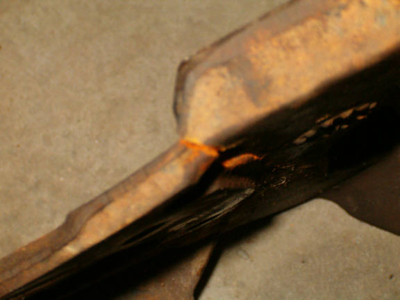

we are getting very good at replacing th axles now by golly-had the thing just about buttoned up, while installing the calipers I looked and was all like WTF is with that? And Eric was like Idunno WTF is up with that? The rotor was at an angle to the calipers still-
everything turns real smooth, but why the angle there?
well the old axle is definitely bent, you can see the wobble when you roll it, and when stood up it leans to one side-
After thinking, and almosrt grabbing a beer and calling it a day we noticed this-

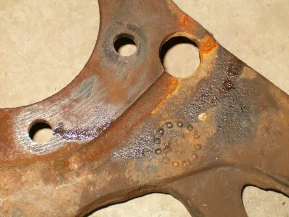

the rear caliper mounting bracket was also bent, and cracked.
So, out comes the axle again to switch this over from eric's stock axle.
Also-the mount tabs on the tube itself needed a bit of re forming-Oh my
The truck this axle came from took a heck of a hit. This stuff should have been noticed before the sale IMO

So what do you guys think the seller should do for compensation? The bearing and seals aren't a problem with me since they should have been replaced anyway, but I shouldn't have had to replace the axle shaft caliper bracket and dust shield. Something needs to be done and he doesn't seem very willing to negotiate
