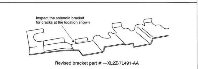

oh ok cool, is the upgraded solenoid bracket what you were talking about when you said bonded separator plates? last ?...I promise....I think
yeah...im definatly just purchasing the epc solenoid....I don't want to dig that deep into my transmission myself. correct me if im wrong here....just pull the epc out and put the new on it....seems easy to me.
The solenoid bracket has to come off to replace a solenoid, buy the bracket. Read the 5R55E thread. Evidently a lot of symptoms have been related to existing gaskets which leak pressure. The bonded gaskets are a wise upgrade, as is any VB kit. The time to pull the pan and fluid and change just the EPC will be about 50% of the task which includes doing the valve body. Yes the valve body work is delicate and must be done very carefully, but many of the improvements are gained there.

yeah Ive already dropped the pan a couple times on it and its not fun. I don't have to touch the valve body when replacing the epc and the updated bracket do I?
The bracket holds the solenoid in place, and has nothing to do with the pan or the valve body. Here's a picture from Glacier991's photo gallery:
