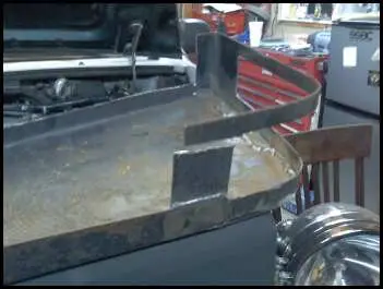

Below is a picture of the offending flare design.
The top and side tabs have to be bent down so that they lay flat against the side of the car and the bottom tabs need to be bend inwards so that they are vertical.
The only idea I've got is to flatten it back out and "hang and bang" the top and side tabs, then to the main angle bends and lastly, the bottom edge bit. It's just difficult because once one bend is made, it interferes with making the others.

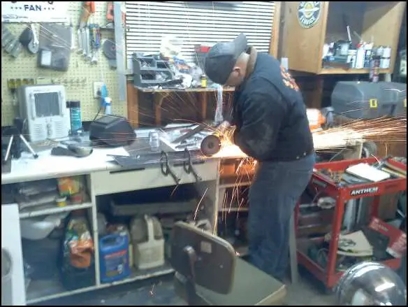

Started with a little work on the fender/bezel.
I ran a bead around the edge, inside and out. Then I took my grinder and got rid of the excess material. In the above picture, you can see the cut I have to make to pull in the bottom edge so that the bezel sits against the light.
After I made that cut and was working on shaping, my friend came by to help out with the fender flare. We started with the main bends which you can see in my previous post. Then he made a couple slits in the other bend lines to make bending easier with the tight angles.
After that it was just a matter of making the bends.
I still need to fill some of the bend slots with the welder, and make a filler piece to match the front quarter contour. Also need to attend to some of the edges and bends to get them nice and straight.

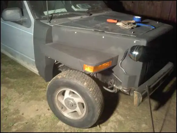

Got a little work done on Friday. Managed to straighten out the right side edge of the hood, finish the right fender flare, weld the fender mounting nuts on the inside of the quarter block out, and been working on the left fender/bezel.
I'm thinking about extending the fender flare down at the rear to make a sort of built in mud flap. Tonight I'll make a template and tape it on to see if I like it.
The left turn signal bezel is taking longer than I expected since it's 16ga rather than 18ga like the left side (eventually, I'll re-do the right fender in 16ga, but the 18 will do for now). But hey, slow and steady wins the race, right?

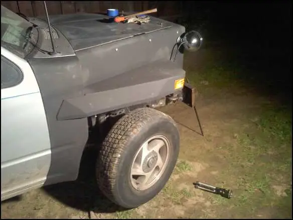

Finally have both fenders finished. Still gotta make the second fender flare, but that's not a biggie. I have run into a problem though.
The left fender that I got from the u-pull place has a different contour! This is driving me nuts. It's about a half inch thinner (as in from the outside skin inwards) than the other one. I thought all 1st gens were the same but I guess not.
This is monumentally frustrating because if it weren't for that problem, I would have it all finished tonight. :mad:

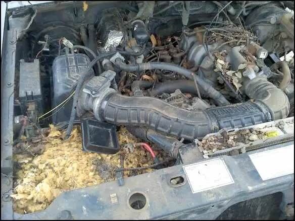

I get a lot of nights like that, haha. It's coming along. Went to u-strip-it and picked up a fender from a '91 eddie. and the guy threw in an engine cover for free. :D Also found a 3" body lift they'll let me have for "10-15 bucks" that I think I'll go and grab to afford me some more rubber-room until I can save enough cash for a lift system.
That '91 eddie bauer was funky. Some sort of critter had made quite a home under the hood.
The fender fits much better than the last one I grabbed, but it's still not quite right. I'm hoping I can square it up with some shims and whatnot.

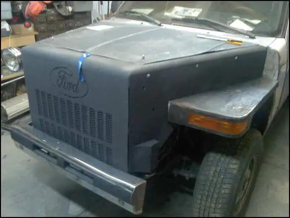

Also, while checking the contour of the fender, I realized how far I've changed the front end.
