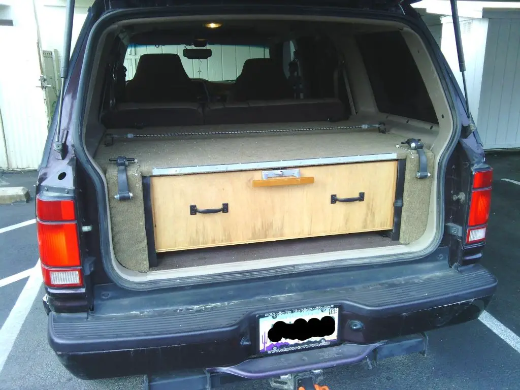

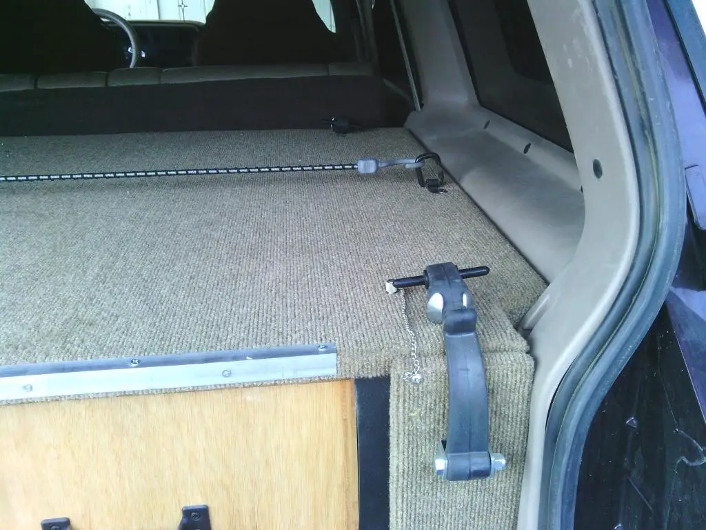

Normal Position:
Drawer extended (300lb of tools in there! :thumbsup:) Deep enough to carry a car battery.

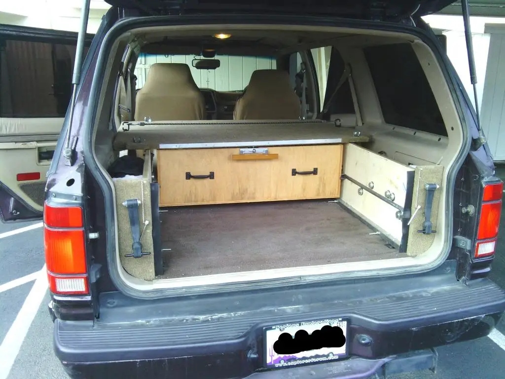

Rolled forward for cargo deck access! :D
(this was the goal for this project) :thumbsup::thumbsup:
Not to loose the ability to stuff a washing machine (full size spare, whatever) in there without removal of the drawer from the vehicle... ..... even with cargo on the shelf! :eek:
As the shelf is free floating some safety straps and pins to hold snug. Testing note: the aluminum " stiffening" needs to be upgraded to steel.

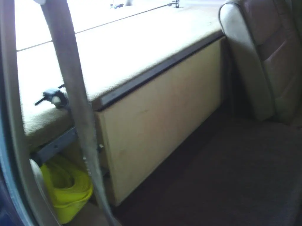

Access to the trail recovery essentials. Tow strap and jumpers right here. :thumbsup:

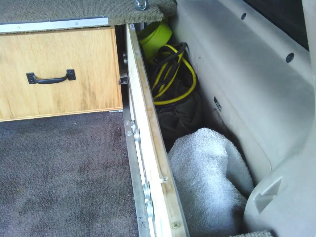

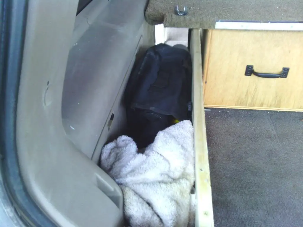

Access to side boxes when rolled forward (lid can be lifted/removed when retracted as long as no cargo is on shelf) (does not interfere with sub woofer):smoke:
Still have access to jack storage: :thumbsup:
Just a plastic glide on front edge to slip over the seat backs. (Simple)
This Thing was fully loaded with camping gear on the shelf and all my tools plus trail spares (spare locking hubs, u-joints, oil, wheel bearings, etc.) on this years TruckHaven run, abused thoroughly and ZERO damage resulted..Tested tough! :hammer:
Really adds to the trail versatility of my Ex. :thumbsup:
Other niceties: :)
Total weight 75lb.
Only attachment is at the factory cargo tie down weld nuts. 8 bolts! and it's out. :thumbsup::thumbsup:
Side support is provided by "L" and "T" brackets with rubber bumpers to protect the side panels.
When this thing is removed there is no evidence left behind. Back to factory original. No drilling/cutting. You don't even have to cut the carpet to install! Resale bonus! :D :thumbsup:
Not exactly cheap $400.00 at least. The rollers are $4.20 each and there are 24 of them! 24 x $4.20 = $100.80
Original design had 18 - Not enough.
3/4 hard wood ply $80
1/2 hard wood ply $65
Carpet, glue, bolts, nuts, square tubing, patio door latch, truck straps, yata yata. lost track, at least $200 more. You can make some improvement here; I used all stainless (mistake) to soft and to expensive. which added to my cost. Had to redo with grade 5 stuff.
Be prepared to spend $400.00 to be realistic. :(
Enjoy! :salute:
Love this truck! .. .. FIRST GENS RULE! :exp:

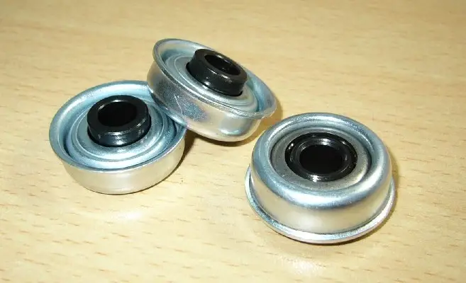

Are those shoulder rollers with a lip ball bearings? What is the purpose of the lip? Do you you have an Ace hardware part number? You did a nice job. I had an idea, but it might not be practical. Could you use garage door hardware or is it too bulky?
Yes, they are sealed ball bearing.
I don't have a part #
If your store has the "National" hardware isle they'll have these.
Garage door hardware is sloppy noisy and weak.

Here are some other "sources" for the bearings (although not sure on weigh capacity):
*Hand truck, dolly, two wheeler, hand cart - some of them use the flanged bearings in the wheels. Maybe cheaper to buy enough wheels (two bearings per wheel) to get needed quantity
*Farm implement parts department - I bought some flanged bearings at my local John Deere for the wheels on a grocery carryout cart
*eBay - I have bought some flanged bearings on there for use on employee carts that are used in grocery stores
