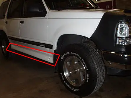

It could be rubbing on both. What size wheels and backspacing do you have? I noticed you have a 94, do you still have the "tupperware" on it?

i'm running a 33x12.5x15 mounted on 15x8 with a 3 3/4 backspace and i think aroubnd a negative 22mm offset. i still have most of the tuberware on the bottom i just removed the one corner piece closest to the tire. should i get wheel spacers and push them out farther?
Wow, I'm surprised you're rubbing with that setup. The farther you push them out, the more it will rub when you turn. I'm almost positive that you're rubbing on the sway bar, but can't really help if you'r not sure if it's rubbing on the back of the fender or not. Figure that out and then we'll be able to help you more. You'll be able to make it work without going higher, unless you want to go higher. :dunno:
