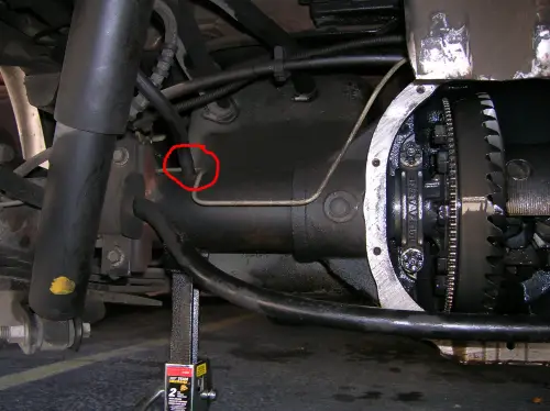

the vent tube on this axle is located on the drivers side tube, the small metal nipple that accepts a rubber hose, the hose leads up to the frame where it terminates into a vent cap.
Remove rubber hose, blow compressed air through fitting into the axle tube
Then blow through the rubber hose, make sure it is free and clear and can breathe, then hook it back up
As I do
As I do not have access to compressed air I will look at it and see if there is an alternative. Thanks for the photo

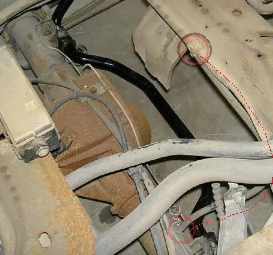

If that vent tube is not attached above the rear housing where it belongs, say hanging down, that could tell you it's got stuff inside it. Normally it's clipped to a cross member above. The small cap on the end is to keep debris out, you may or may not be able to blow through it. It'll be nasty, I've never thought to need to blow through that hose. If I did, I'd remove the cap carefully and blow through the end.
Here's one of my pictures that someone else traced a line along the vent hose.
View attachment 324821 has been closed off
I couldn't find the necessary vent tubing , but by using your photographs determined where it should be. It appears that the vent has been closed off and is no longer used. Someone mentioned it would cause a leaky oil seal after 20,000K. In my circumstance and with the hose no longer there I guess I will just look for the the leak in 20,000 k.
