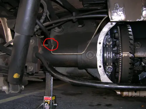

the vent tube on this axle is located on the drivers side tube, the small metal nipple that accepts a rubber hose, the hose leads up to the frame where it terminates into a vent cap.
Remove rubber hose, blow compressed air through fitting into the axle tube
Then blow through the rubber hose, make sure it is free and clear and can breathe, then hook it back up
