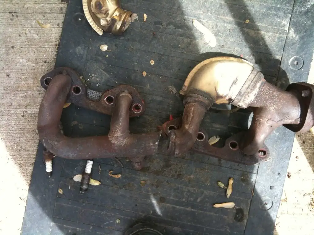

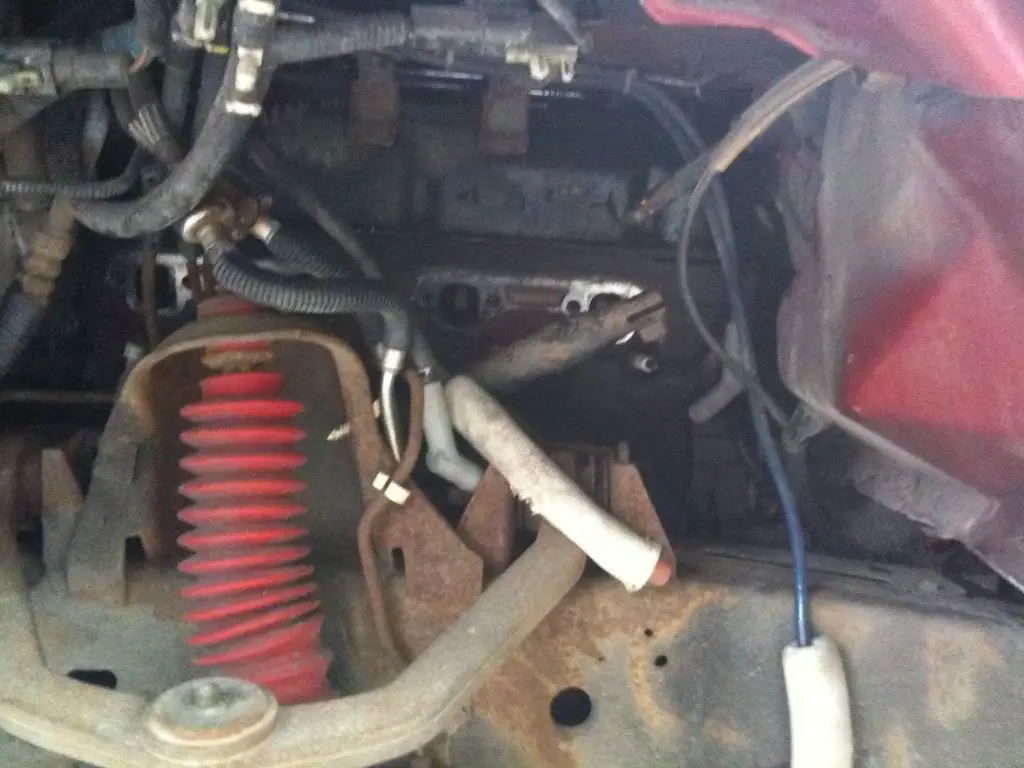

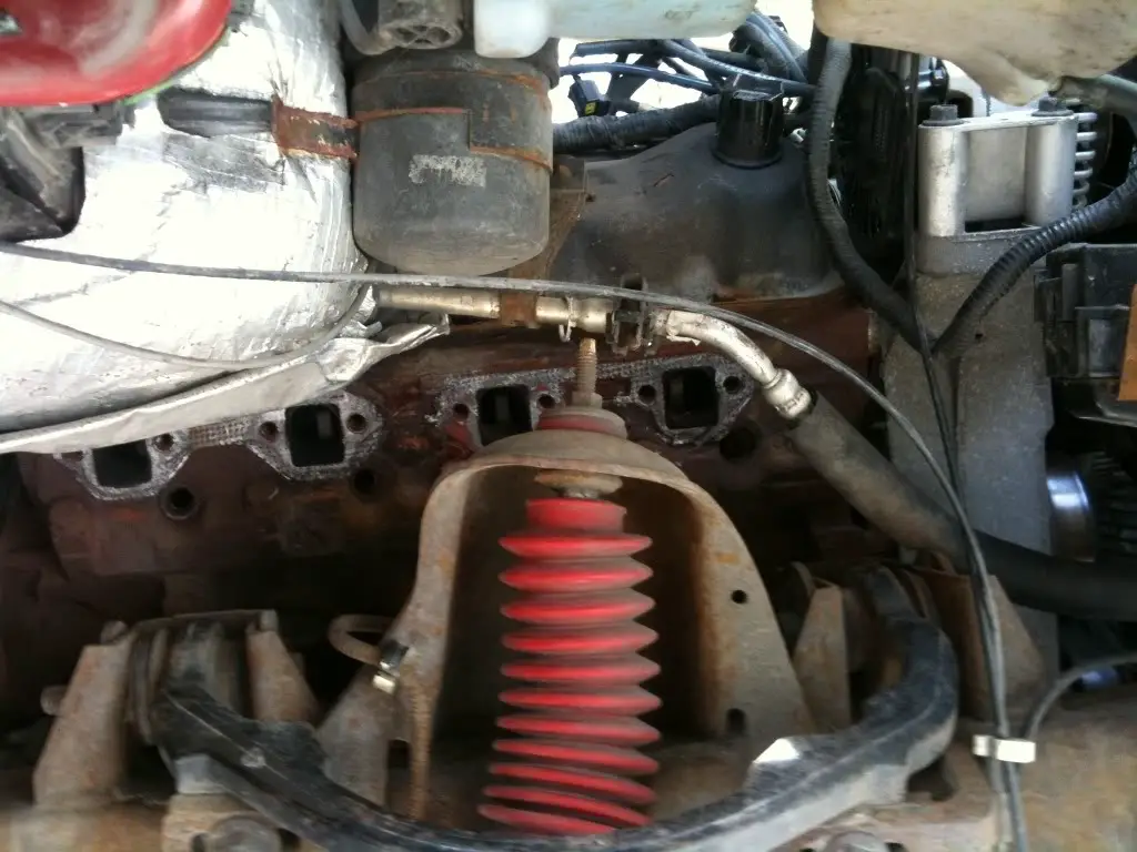

We used the saw to cut the egr tube and both passenger side collector bolts that were seized in place.
They're not in yet, jon is going to powder coat some valve covers for him. So we have to wait for those to get done and put on before we put the headers on.
Edit: we also had to cut the passenger side manifold in half so we could get to the back colle tor bolt and cut it.
Drivers side is on. Valve covers are baking for the last rime now, well get those on tonight then they'll have to put the upper on in the morning since it won't be cool enough to put on tonight.

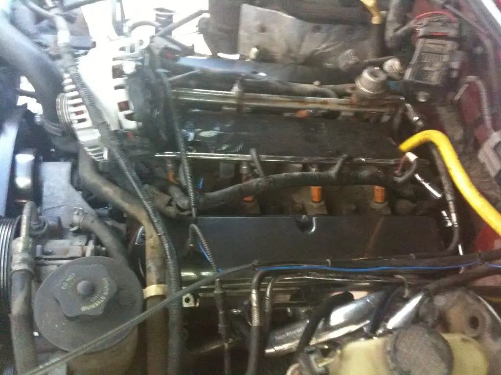

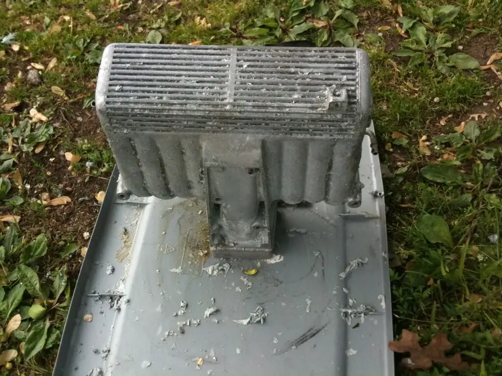

These pics are for Dan so he has something to reference while putting his intake together in the morning.
