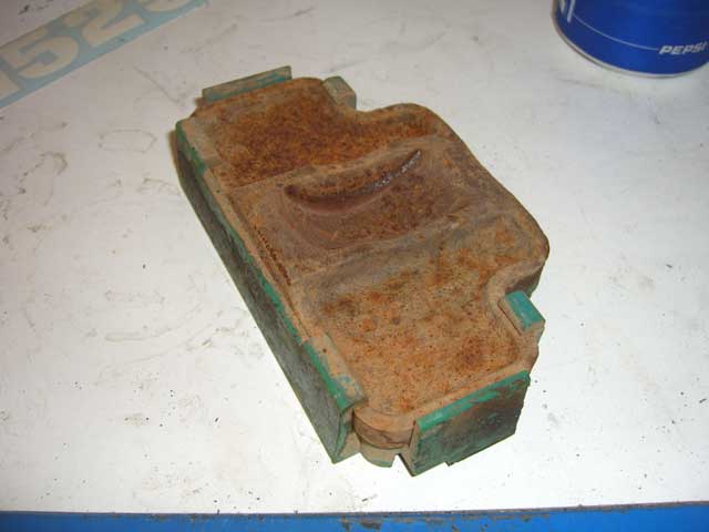

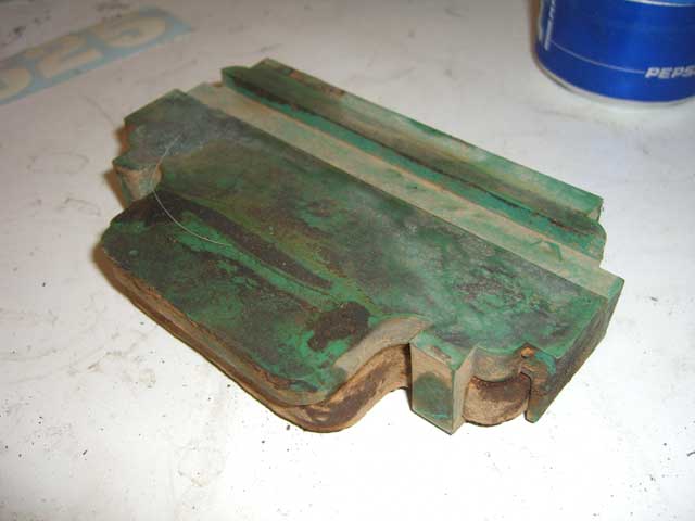

My 98 Mounty has these metal plates, with a blue plastic-rubber material about 1/4" thick, on 1/8"metal plates. Almost constructed like a brake pad.The plastic side goes up against the frame, the metal side has grooves for the tosion keys to ride in. There was nothing between the metal plate and torsion key.On mine these plates were actually a hassle while flipping the keys, as both hung up on each other.I wedged some rubber inner fender material behind the plate when I reinstalled, noise went away but is returning muffled but getting louder. I know I'm onto it now!!
Somebody here has surely seen these, possibly have a part number for me? I really don't want to take it apart, but the part # is stamped on it, I remember looking to see if they were numbered side to side, they are same

what up man how are you/ I had to REPLACE MY right control arm after going off the road at 70, and I happened to pull one of those little blue things out. I would be happy to get you the part number if you haven't gotten it already. Also, where is my bumper? lol.
I have these laying in my pile of IFS parts on the back deck. I'll get some pics and #s tomorrow too.
Why didn't you remind me?? :p
F87A 5B334 BA

Thanks soo much
This has been one of those back burner things
When people ride with me , I say
"ok its going to"-- POP-- "do that right there"
and go on with life ha ha
I am going to replace them, thanks for making it easy
