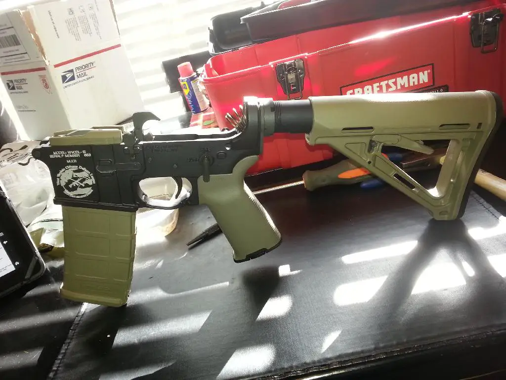

Here you go!
That's where I'm at. Lower completely done. I just need to start on the upper. Thinking I may buy a completed upper, but I'd really like to learn how to build one. Of course, that would be a good opportunity for building another one! :D
The receiver I used is a custom item made here in West Virginia by III ARMS Co. The engraving is the WVCDL (West Virginia Citizens Defense League) logo. I'm a member and the group deals with 2A rights.
