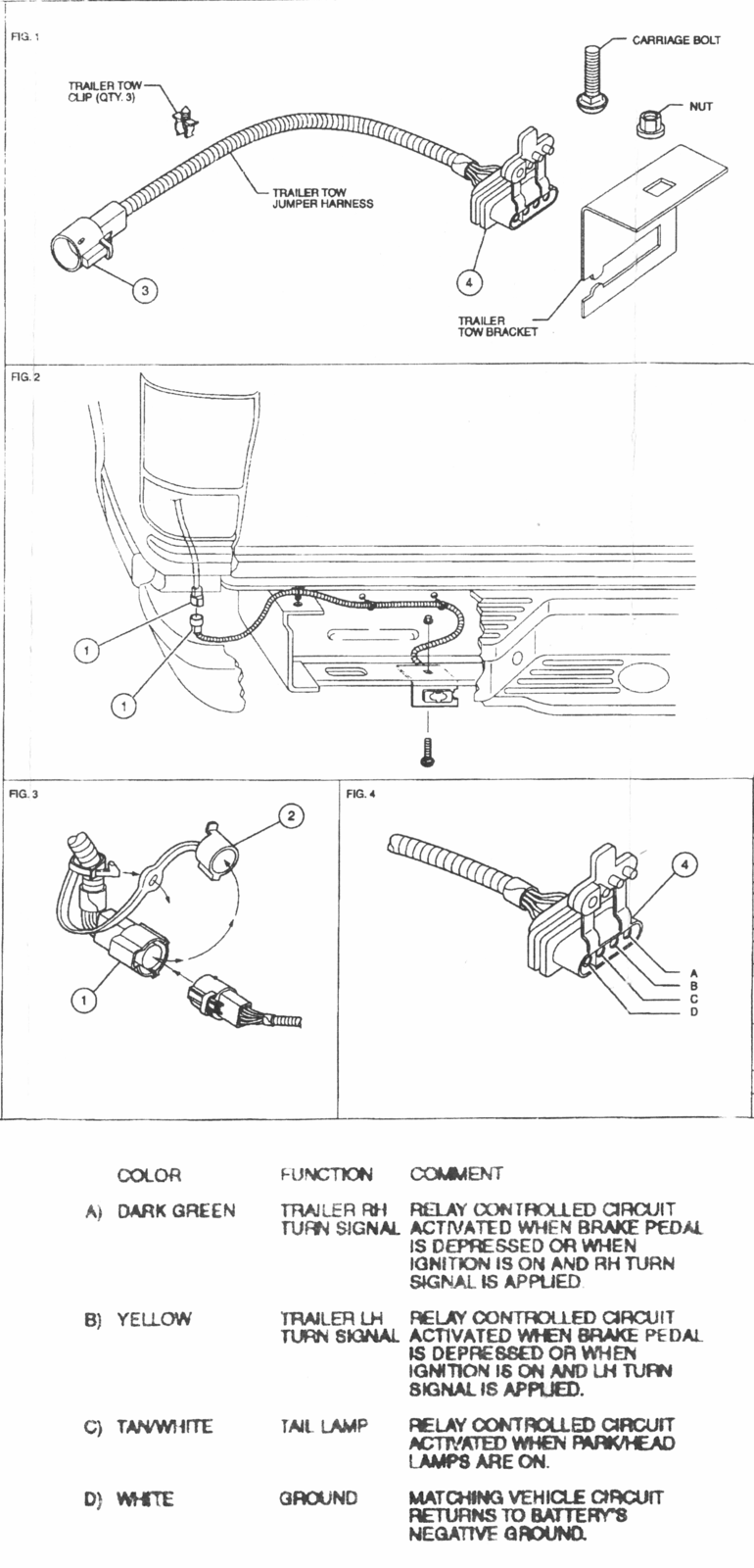

Looking to get a camper and pull it from Utah to Pa. The max weight on NADA guides says the tow capacity is 3500lbs. Is that accurate? I know these aren't built for towing but it's the only vehicle I've got. It does have the factory tow package and the superior shift kit upgrade. But it is only a V6. Anyone tow a camper with yours? What is the length and weight of your campers.
