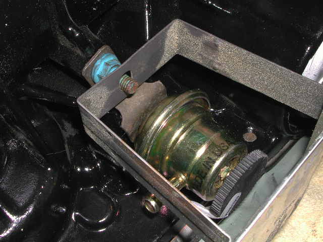

Here is a picture of an adjustable modulator inside of the heat shield from Glacier991's photo gallery:
Wow, that is cool. I am sure I can find that. Hopefully it will be a fun weekend project. Or I will be completely bald Monday. Either way, I really appreciate the help.
The only way to see the solenoid at this angle without dropping the tranny is to remove the passenger seat and the center console, pull back the carpet and remove the access plate (on the hump).
The modulator sticks out the passenger side, near the top of the tranny, behind a cat heat shield (that's the bracket shown in the picture loosely installed on the stud).
The modulator is nearly impossible to see or remove from under the truck.
