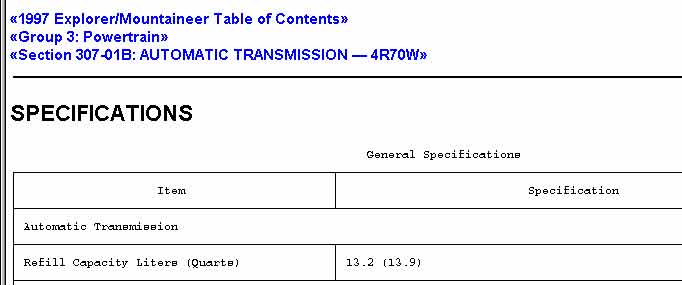

sorry to jack the thread, but how much tranny fluid should my 98 v8 explorer have?
