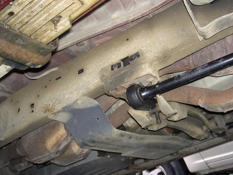

Can you remove the center portion of the crossmember without messing with the torsion bars? That was my first idea until I remembered that the torsion bars attach to it. I’m fine with removing the crossmember as long as the truck doesn’t fall on me :thumbsup:
The torsion bars mount against the frame, it's a short section welded to the inner part of the frame. The cross member bolts to those on each side with two bolts. The member is an important piece that has to be there, but you can drop it for maintenance etc. Here's the best picture I have of mine when I rebuilt the front suspension, new T-bars etc.
