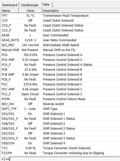

Went to go get my mail today (about 1/4 mile down the road) and when I put the snifter in D after checking the mail to head back nothing happened.
Had to walk back to the house then push it back with another car.
All the electronics seem to be functioning the same as they were before it quit. I'm at nearly 240K on the vehicle so I don't know if it's worth fixing or not.
