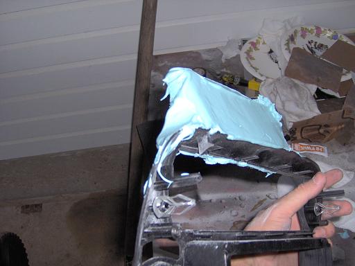

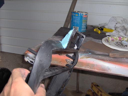

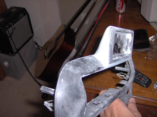

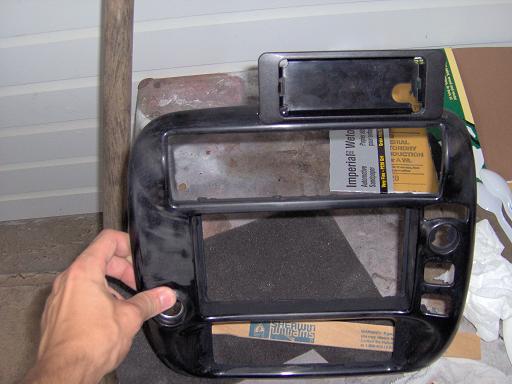

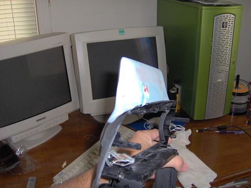

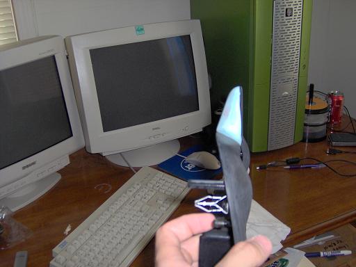

I went ahead and started on the XM today. Here are a few pictures. I started by JB Welding the shroud onto the radio surround. Then I put on the first coat of Bondo Ultimate.

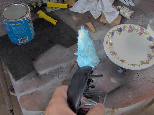

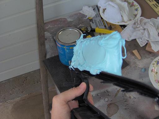

I then trimmed up the bondo a little with a knife before it got hard... sanded a little, and hit it with the second coat.

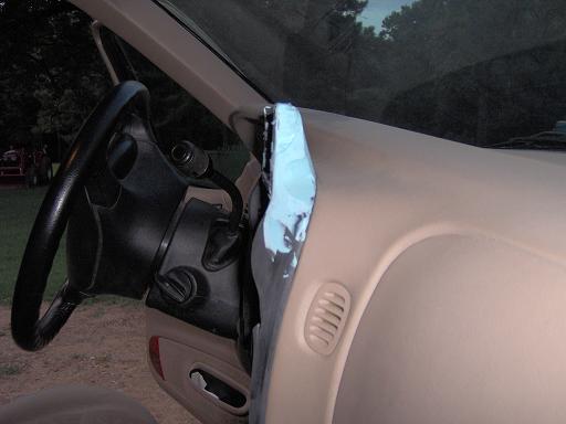

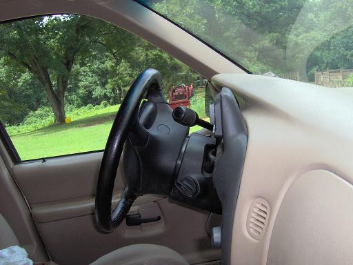

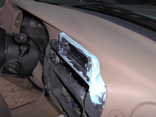

now comes the test fit....

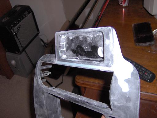

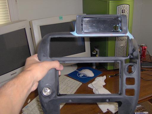

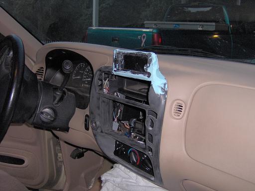

These are the last pictures I took before I called it a day. Most of the sanding is finished. I may have to skim it with more filler tomorrow....I wont know til I sand a little more.

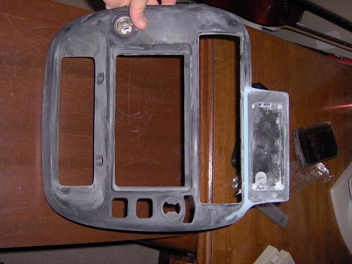

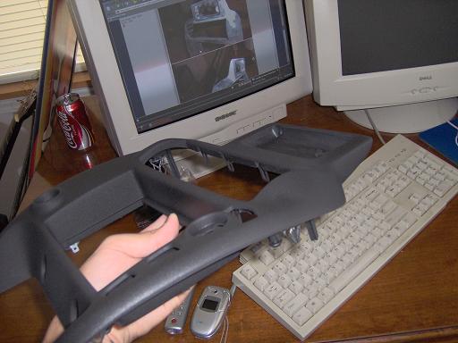

Here are the final sanding pictures. I ended up sanding a little and hitting it with one coat of glazing compound. I then wet sanded it with 400grit. You can see the hole in the back for the cable of the radio... the end of the cable it pretty big. You wont see the hole when it is mounted.

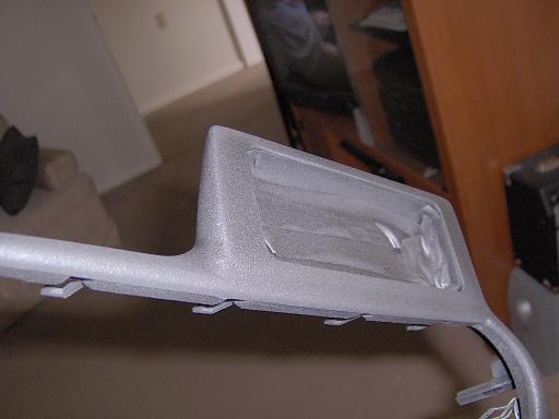

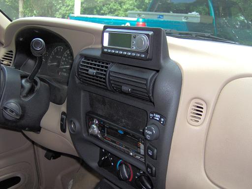

These pictures were after I coated it with Duplicolor Spray Bedliner. It turned out pretty good I think. I hope to have pictures of it installed in a few hours.

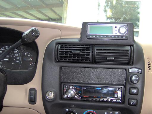

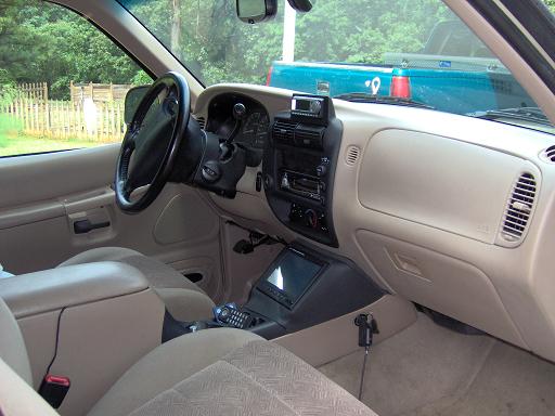

Here are the finished pictures. MAN this thing turned out good... alot better than I expected. Enjoy.
One more picture... I can only load 3 pictures to a single post.
