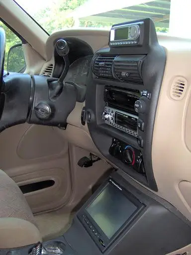

I also got an overhead console from eBay for $20 shipped... I got the one for a sunroof equipped truck, which I thought was the same size, but it is 2-3 inches longer which is a good thing. This lets me put a 7 inch monitor in the console without conflicting with the visors. With the non sunroof console, I could only fit about a 5.6inch screen- anything wider would keep the visors from operating.

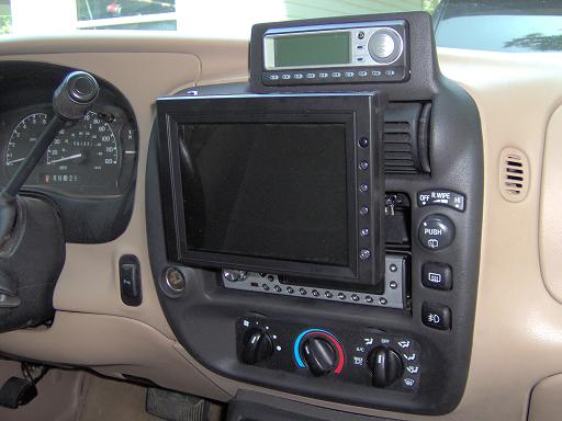

I got started on the overhead console today. It turned out to be more difficult that I thought. I planned on getting rid of the seam where the tan and black parts meet, but I found out that the electronics have to be put back in with the two pieces separated. So what I plan to do is leave the front bezel removable as to install the electronics and remove the seam on the rear portion. The part where the sunroof button hole is now is where the screen will be molded.

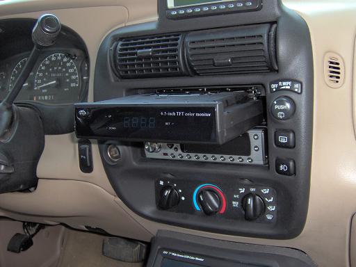

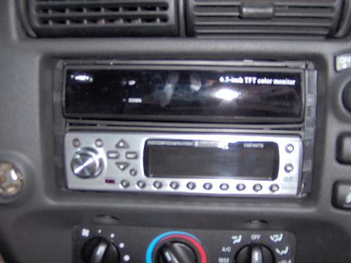

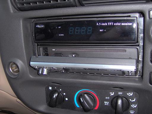

The stuff came in this morning so I went ahead and installed it. I ordered the 6.5 inch screen instead of the 7 because it looked as if the 6.5 came out of the dash more. If it wouldnt come out enough, it wouldnt open up all the way and because of how deep the units mount..... but I found out when I opened the box that the 6.5 and 7 are identical except for the actual screen... oh well. I had to trim the install kit a good bit to get the HU to fit. The faceplate of this radio is wider than my old radio and it wanted to rub on the install kit. The only problem I have is that the face wont open up all of the way because of how far the volume know sticks out. It isnt really a problem though, it opens enough to get disks in/out.

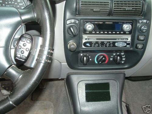

this is a picture of a truck I saw on ebay. You could put your screen in the console like his and put you DVD player in with the HU with a Double Din kit. It will take some work getting the DD kit right, but it looks good when finished. I lost the trim piece that goes around everything like this one does. I dont remember who makes this kit, but I got mine for free from sounddomain.com with my old radio. The DVD player would have to go under the radio because there wont be enough room for you radio to open up if it is on the bottom.
