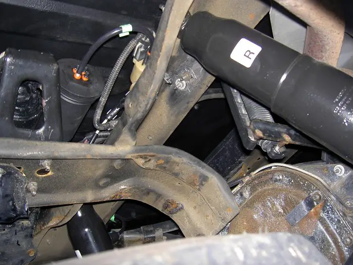

The height sensor in back is about $200 for me, the good price at Ford. They have joints that do wear out. The height is not adjustable, but I did it. I drilled two new holes in the cross member. It only took about 3/8" to lower it about an inch.
Sorry about the heat/height typo above.

I want to lower mine as since I put the shackles on it triggers less then b4. I will look at that next sunday if the weather is good...must charge the drill first to relocate the mount.
The height sensor determines what level the ARC will try for. So mechanically altering the ride height does not change the height sensor ride height.
If you lower the truck(blocks etc.), the shocks will have air added to return to the original height.
If you raise the truck(shackles etc.), the shocks will have all of the air removed from them, which will ruin the shock.
Meaning you have to alter the height sensor also. If you go by my picture above, you can generally see how I lowered my truck just shy of an inch, probably 3/4" from stock. I have 1" lowering blocks, and moving the height sensor upper mount about 3/8" upward got me that slight drop. Be careful because you can't raise it much more than that, the bracket of the height sensor will touch the floor of the truck and push it down, , defeating what you are trying to do. I had to play with it for a good while to figure that all out, and get the right location and clearance. Make clearance at the floor as you go.
If you need to raise the truck, going the other way(down with bracket) is not as tough.
