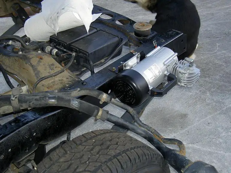

I don't know if I have a picture showing the wiring, I installed my ARC system(from scratch) in 2005, with new shocks. So I never dealt with the wiring etc, I just tied it off. My dash light never comes on, it may if the main switch is shut off.
The wiring connectors are gray, clearly they may only be US features. It can be seen here on the far left, lying up on top of the cross member. I wasn't even close with the ARC at that point. I had just finished adding the ARC wiring to the frame harness.
