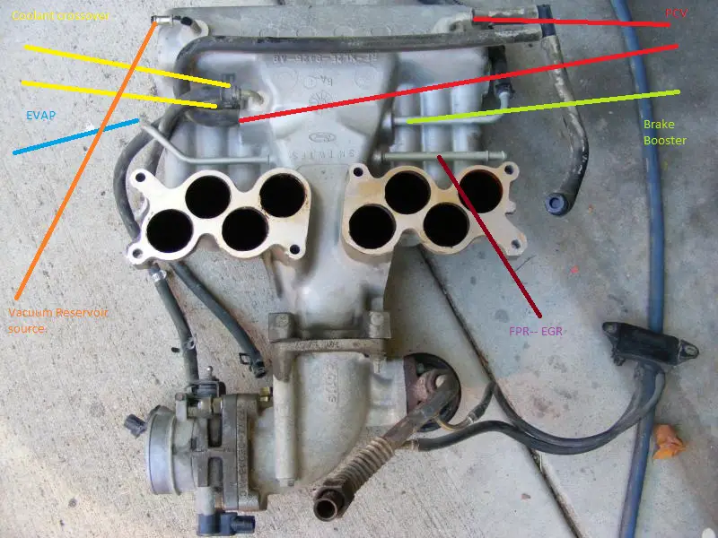

hey guys ive got a 1998 5.0 and just had the engine rebuilt ive almost got the truck all back together and road worthy but i cant figure out how to hook up all the vacum lines . i need to know what hooks up to what . ive got diagrams but im having trouble reading them . if any one could post pics of the vacum connections on the intake and what they go to id be much appreciated.
Others please correct me if I am wrong, but here goes
