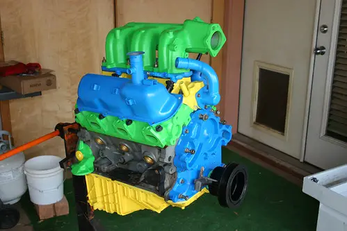

Those might have been mine.
The explorer 4.0 ohv motor.
The 460 Motor in the tow rig.
That is all done with engine paint. Turdles powder coating is amazing, I wish I could have had him coat some of the motor parts..
~Mark
those are the ones. i was rappin about...
BTW the green thins are the cylinder heads no? i have to check mine out. im pretty sure they are.
ahhh, the lego engines,,
looking weird, but good,
hahahaha wow i like the paint. looks like ill pull out the ol powder coat gun again....if i can find it (messy garage). SO does anyone happen to have a 4.0 that is rebuildable that they want to sell?
Yes, on the 460, the green things are the heads..
On the 4.0 (explorer) the green things are heads, upper intake and the oil filter adapter/mount.
~Mark

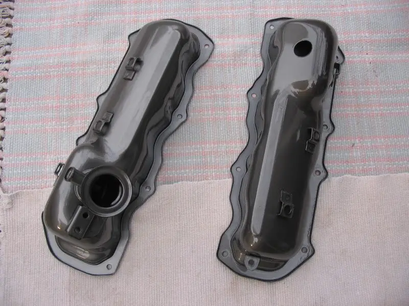

Those are great looking...
Seriously, how much work is it to powdercoat those? And can you powdercoat aluminum as well? Like an OHV timing chain cover?
And what is the cost for those?
Aluminum is no problem, although a timing cover is tricky to mask off and requires a bit more work than 2 valve covers.
For these I would like 45.00 and your old set returned. For a solid non metallic color 40.00 exchange.
The covers in the picture have a second coat of clear powder, which requires a second cure cycle, so 5.00 more for clear.
First I take the old ones and run them thru a "self clean" cycle in my small oven to burn off all the old powdercoating and oil. Obviously this only works with steel parts.
Then they get bead blasted clean, and coated. It takes a total of about 5 hours to end up with this
Soon ( hopefully tonight) I will have another set like this, and, an upper intake manifold, water neck to match available.
I plan on this same color unless someone speaks up for another--
THose look sweet. i want my upper intake to look like that.

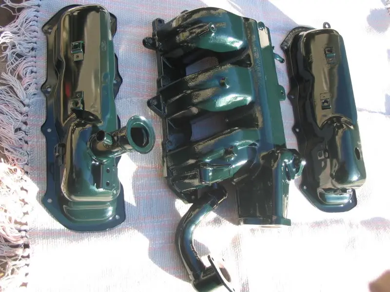

I also have this " hunter green metallic" set of valve covers and water neck available for 45.00 exchange.
The intake is gone but I could do another to match.
Okay, I'm diggin' the black chrome! How much would it run me for a set of valve covers, water neck, and upper intake in black chrome shipped to 27262? (With my old ones sent back, right?) You do some nice work, those things are nice!
