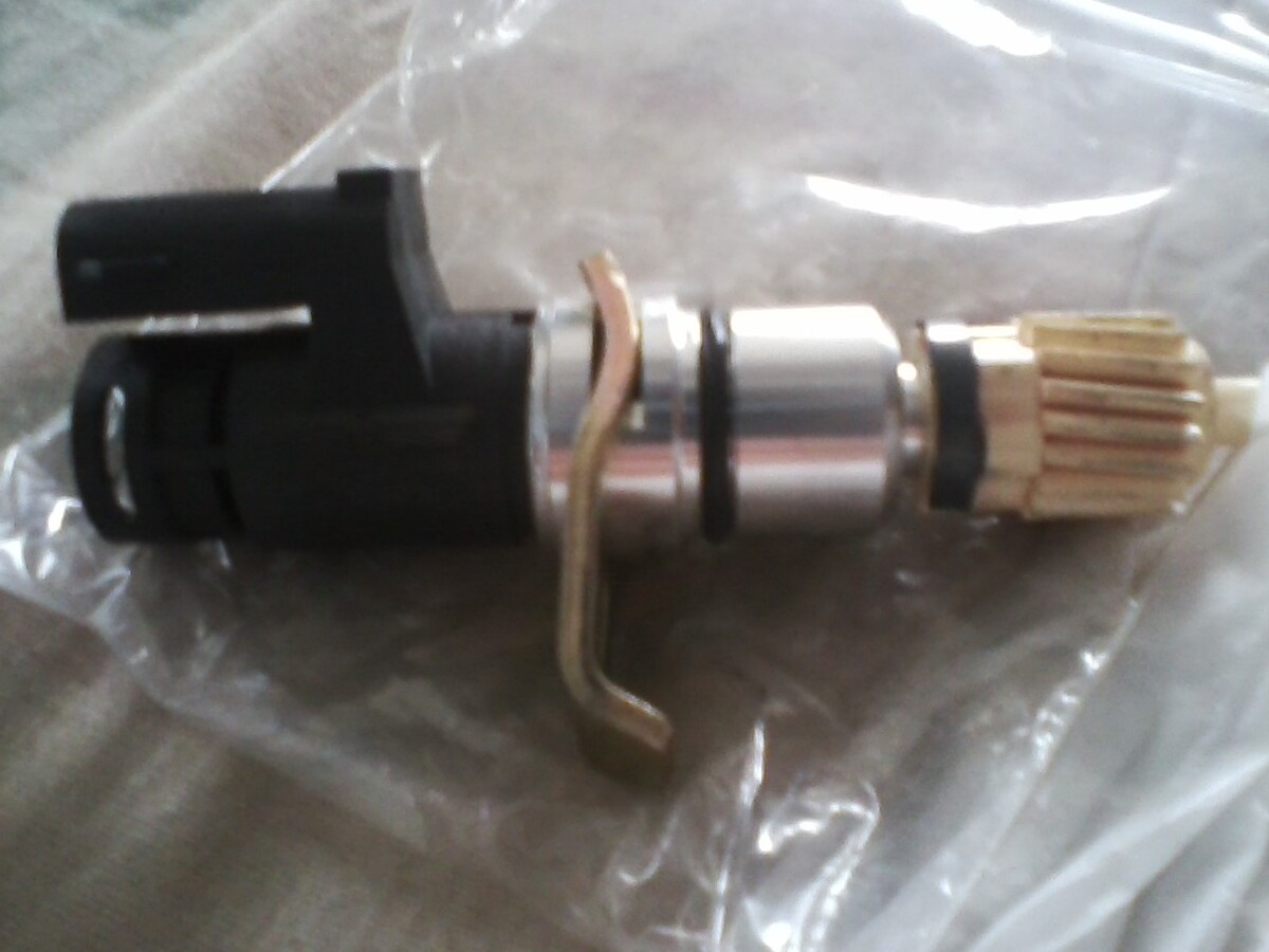

I have a 1996 Ford Explorer 4x4 and the speedo works for about 5-10 mins of driving then bounces a lot and then completely stops. The odometer doesn't work at all. So I was wondering if someone could guide me on how to replace this myself. Pics, explanations, location of this thing. Will I lose fluid with what ever part it's in?
When mine went, it didn't work at all...Here's a pic of one and a video, if it's a 4wd then it's mounted on the transfercase, 2wd I imagine on the tail end of the tranny, you shouldn't loose any fluid changing the part out...Also you'll have to reuse the plastic gear on it, there's a clip that holds it on...

Thank you! I will most likely be changing it this week by myself. I just needed to know the location of it and if I'll be leaking any fluids because I'd wanna be prepared if I did. I hope the gear on the end I have to switch onto the new one is easy slide off and back on.
