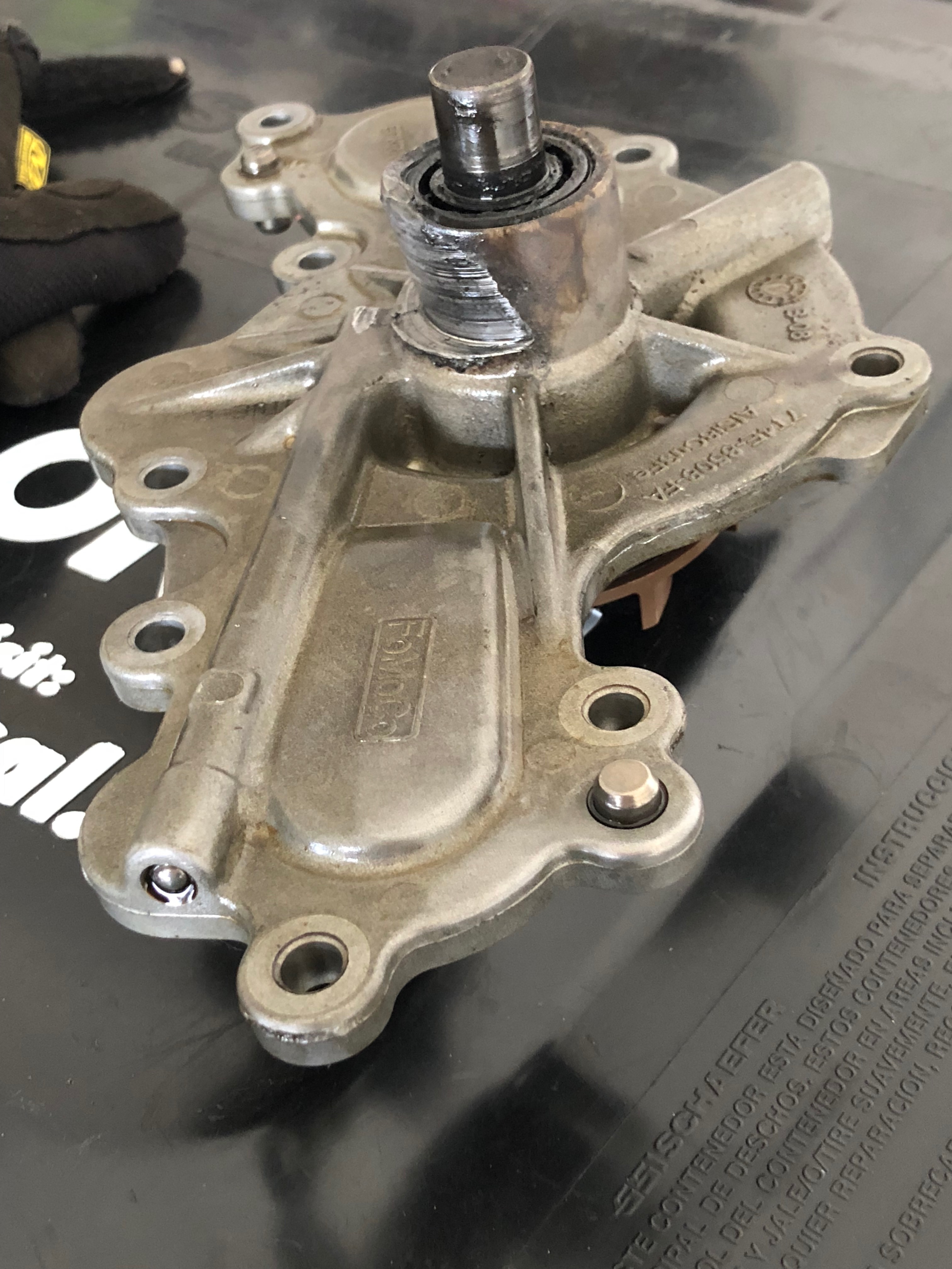

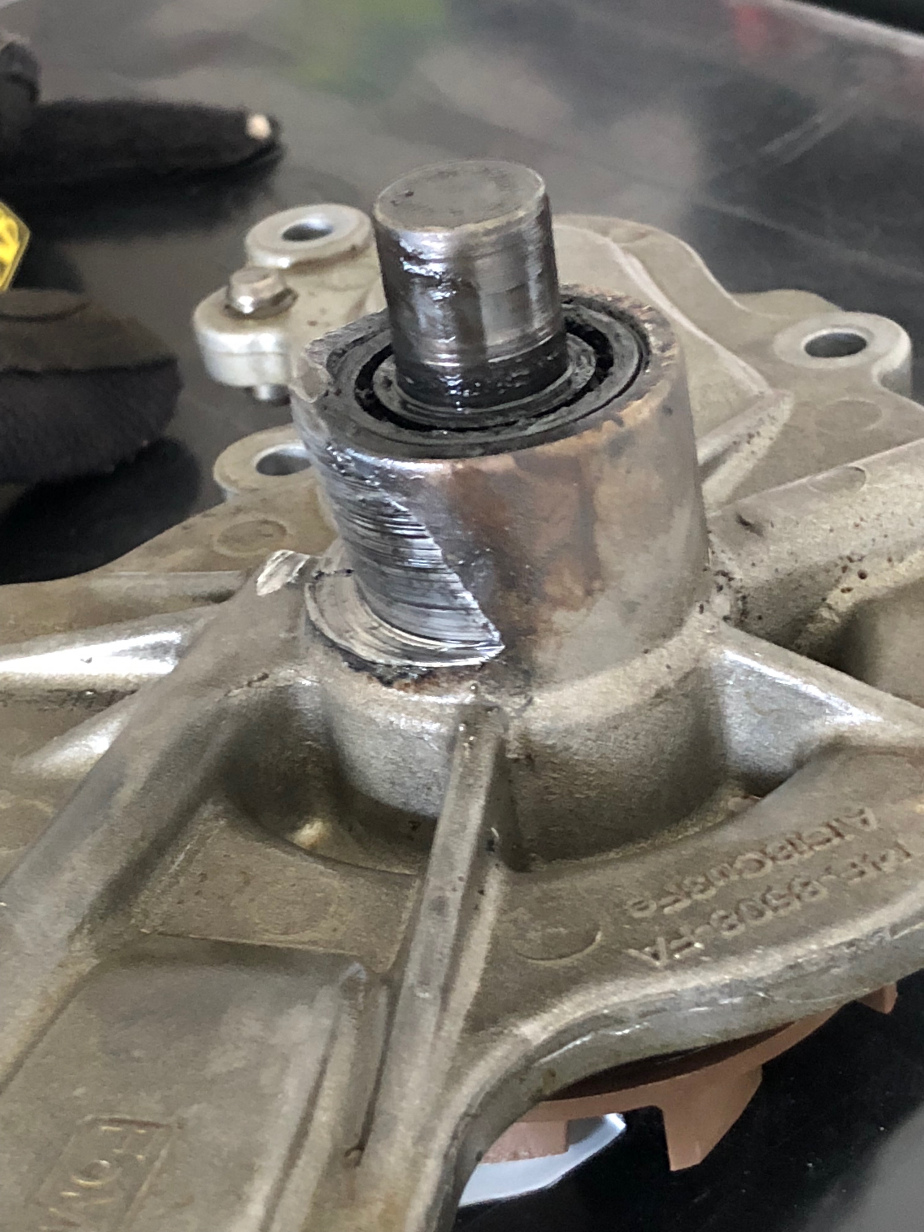

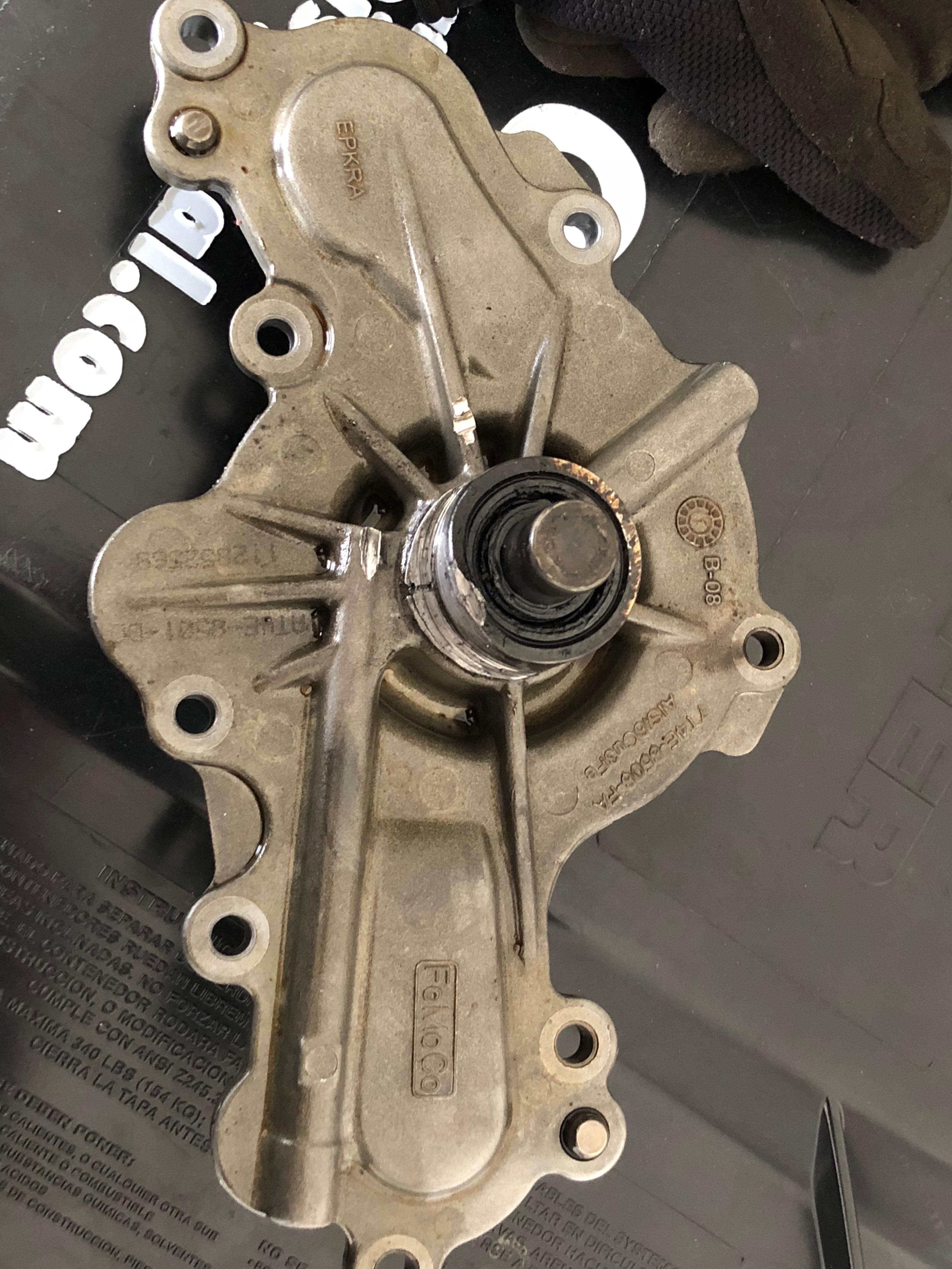

$3430.50. Just picked it up. I had them save the old parts.
With the scoring of the bearing and housing, and the amount of heat marks that it is showing, I am wondering what was going on inside that engine to cause that. That scoring and resulting heat is what caused the seal to fail. I would also be wondering where those metal particles went. If they are loose inside the engine, they can cause a main or rod bearing failure. A magnetic drain plug might help to catch some of the particles before they can do any damage, however, a magnet isn't going to catch the aluminum particles. Did you discuss this with the service manager, and if so, what was his thoughts. If you loose a rod or main bearing, you are going to going back into that engine for another expensive repair.
I would assume, the bigger pieces of metal dropped into the oil pan/sump and stayed there. Any other suspended pieces should be caught by the oil filter......in theory.
Fortunately it was caught early with minimal leakage into the oil pan but the loose shaft caused problems with the timing chain. There is great information on the Flex forum as the 3.5 has been in the flex since introduction in 2007. Ford reportedly redesigned the water pump (beefed up the shaft and sprocket) and chain to accomodate the new pump and intro'd them into the 3.5 in the 12 model year. Timing Chain / Water Pump Replacement - 2010 EB - Ford Flex Forum You can see in the photos the old and new pump and chain in side by side pictures.
It's always smart to ask them to save the old parts to verify the repair. From what I see the water pump bearings may have failed first causing the spindle to become lose which caused the timing chain to fall off the sprocket or the bearings going bad was due to the timing chain slowly becoming disengaged from the single tooth row on the sprocket that caused it to wiggle and ruin the bearings before finally falling off. If it was the later, the redesigned duel tooth sprocket and more beefed up timing chain makes sense, but if the root cause was the bearings going bad that caused the coolant to leak, I'm not sure having a more heavy duty timing chain and double tooth sprocket would do anything more than to prevent the timing chain from falling off the sprocket.
Bottom-line, anything that spins a lot at high RPM's does not last forever, wheel bearings, turbos, etc., so having it inside the engine block is a poor design at best. I also assume the 3.5L engine was put in the Explorer to meet CAFE emissions standards, but with $3,400 repair bill, the emissions standards may have been met, but with no fuel savings to the owner.
