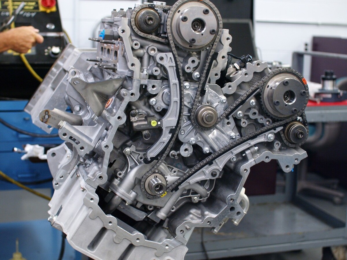

I just don’t understand how the failing water pump leaks into the engine and can destroy it so quickly. How is that even possible? And why wouldn’t it have leaked into my engine like others instead of onto the ground like it did? I’m fairly mechanically inclined (not an expert by any means, but I do have a mechanical mind) and it just doesn’t make sense to me. Isnt the only place coolant can enter the engine at the head gasket?

This picture shows the internal timing chain driven water pump and the direct path for coolant to take to get to the oil pan.
http://www.blogcdn.com/www.autobloggreen.com/media/2008/08/zz7a5ad63a.jpg
Ok I’m starting to understand. So under normal/ideal circumstances the weep hole would function correctly and expel coolant to the exterior of the engine, but it COULD in some cases not leak from the weep hole and instead leak from a seal on the water pump directly into the engine oil. Is that correct?
You got it exactly. Seal on both sides, if it fails internally, it goes in. If it fails externally, it goes out the weep hole.

VERY interesting and very informative thank you. I guess the moral of the story is check coolant level and inspect oil often.
