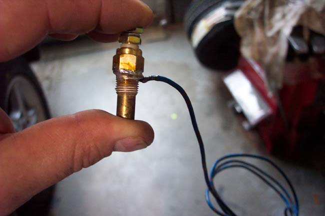

Okay, the temp sender body needed to be grounded. The factory sender location is in some sort of composite body. So I had to create a body ground for the sender. See photo 1. I striped a good two inches from the wire and tinned it ( soaked it with solder ) Then I wraped it around the body of the sensor. I then reheated it to get the solder to flow onto the brass. The one in the picture was a practice " to see if it could be done ". The one that actually went into the truck looked a good bit cleaner.
I orgionally grounded it to the valve cover as seen in photo two. This is NOT a sufficent ground. It does in fact ground, but it does not allow the guage to read correctly. I moved the ground to the fire wall right by the wiper motor and that turend out to be perfect.
The end result is a guage that reads with in 3 degreese or less of the ECM.
