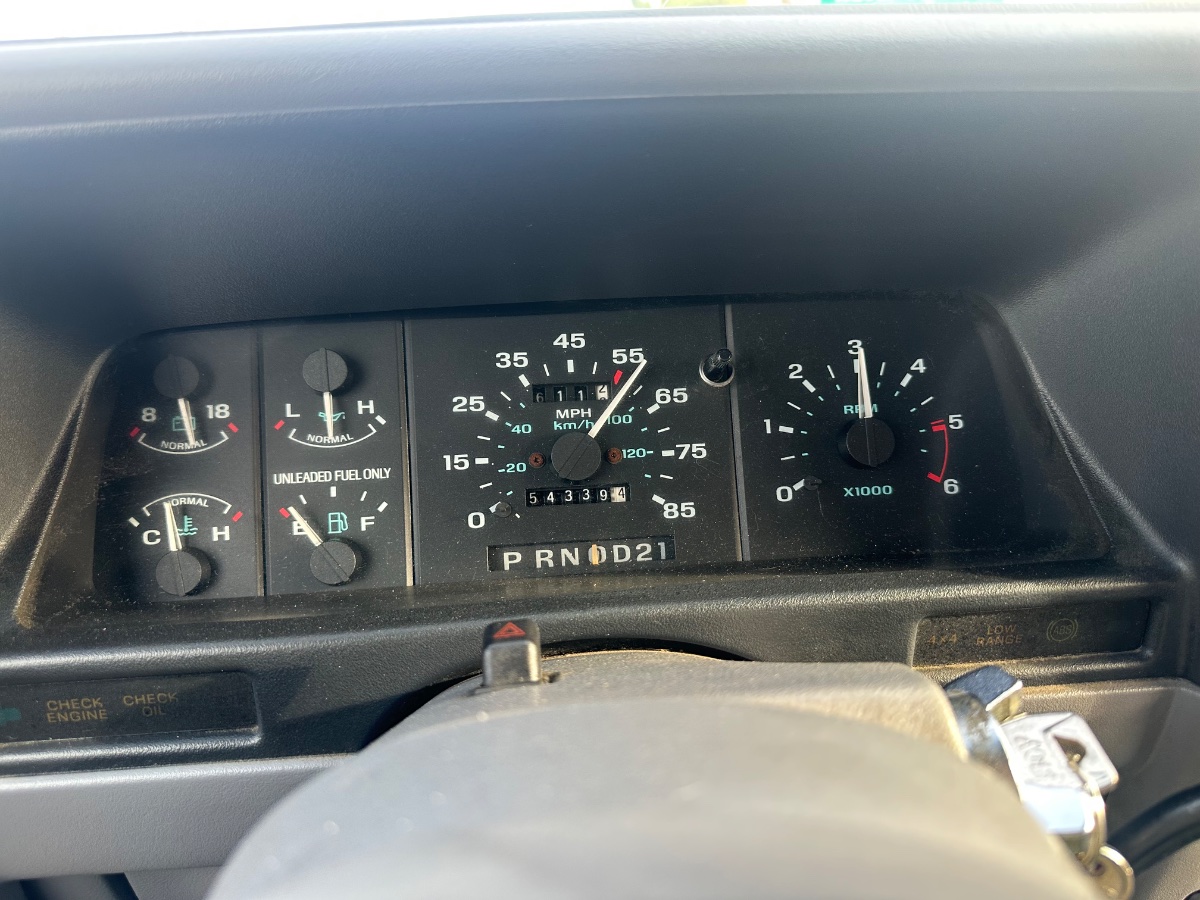

Hey everyone. So I’m the new owner of a 1194 explorer limited. It’s all stock and has been a blast to drive but it’s got a weird trans issue
As stated above it’s a A4LD trans.
Shifter in the first D setting “OD”
If I accelerate on to the highway it’ll shift 4 times and drive for about 20 seconds in over drive. After about 20 seconds it’ll feel like it drops a gear. Rpm will jump up to around 3000 (55mph vehicle speed) and it will not shift back up no matter what speed I go.
Now, while cruising like this, if I shift down to the second D it’ll drop a gear (again?) and rpms will increase again from 3000 to 4000
I’m super confused in what’s happening during the first annd second increase in rpm since this trans is a 4 speed?
also, a note to add is my cruise control doesnt work.
I need overdrive to work.
Any help would be appreciated!
See pics below. Note shifter indicator position, speed, and rpm.

What size tires do you have and what axle ratio? 4k rpm in 3rd gear at 55 mph seems high.

Note how hard it “shifts” down. At the 24 second mark it looks like it shifts down twice? Maybe first is tcc and second is shifting into 3 gear? After that I shifted to second D setting and it shifted down again.

Based on the math, 4k rpm is 2nd gear and 3k rpm is overdrive applied to 2nd gear. Forgive my original guess, it appears you lost 3rd gear

ok so i read this post incorrectly. it does appear i lost 3rd gear. i was out and about just now and tested this theory. i put the shifter in 2nd gear and mergged on to the highwat 55-60mph was 4,000 rpm. shifted up into D "3RD" no shift no change in rpm. i shifted into OD and it shifted up and rpm dropped to 3000. so this trans can apply overdrive to any gear? im not super familiar with how this works

Gears 1-3 are hydraulic shifted so the only feedback the ecm uses is the speed sensor, it assumes at 55 mph the transmission is in 3rd gear. The newer 5R55E uses the OD and 1st gear to create a 2nd gear that has a ratio between 1st and 2nd gear.
