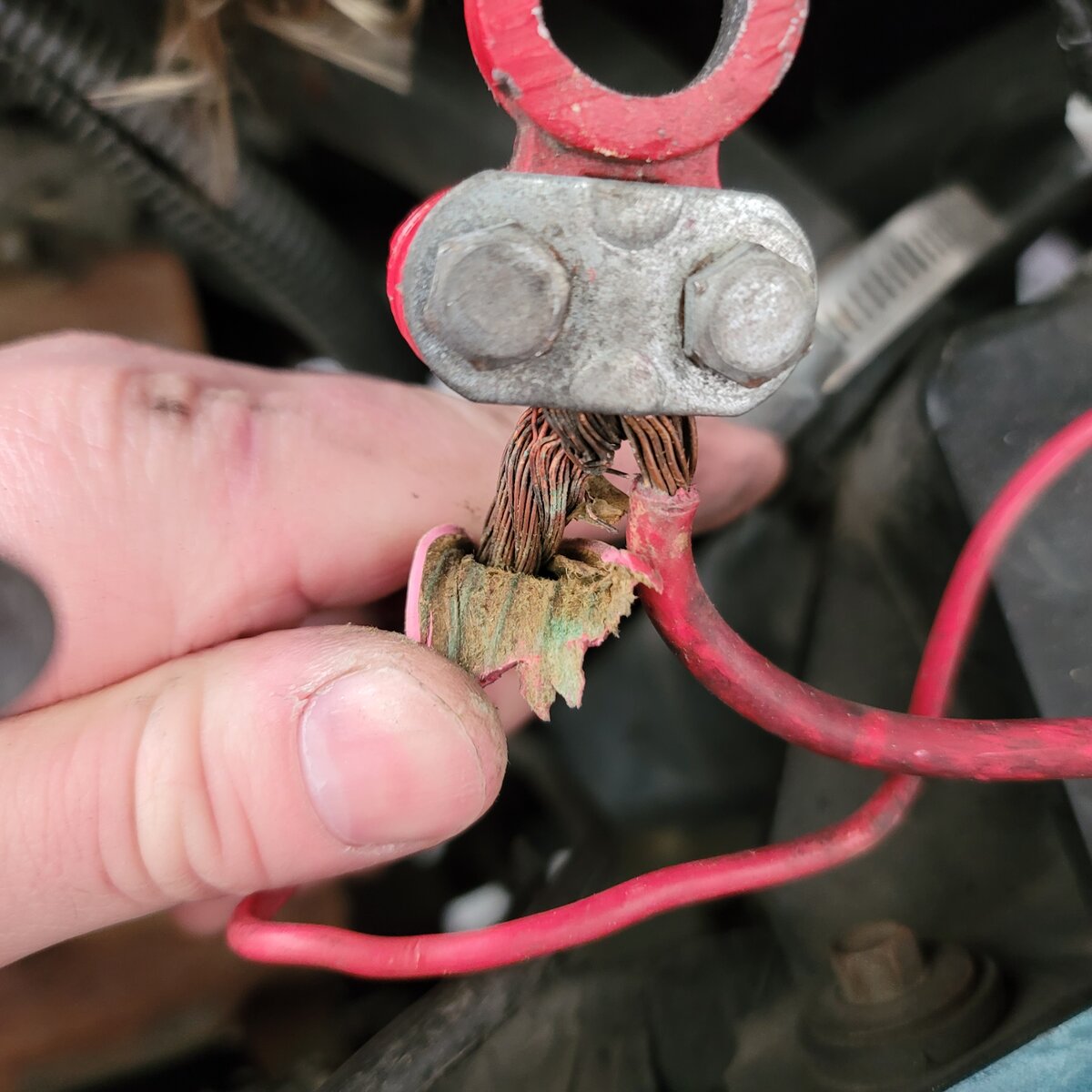

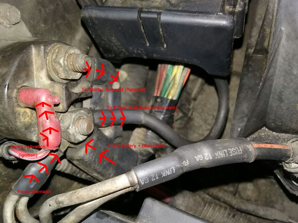

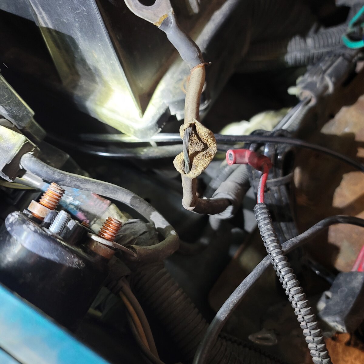

First the electrical. So to shorten the story i was talking to another individual with his help narrowed it to heavy corrosion down stream on both positive and negative wires off the battery along with a blown out fuseable link.
The TPS wires that go back to the harness near the alternator i believe was also showing signs of a bad wire and went ahead and replaced that 1 wire of 3 as well .
