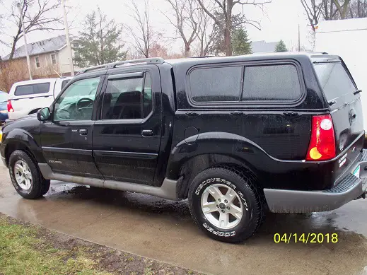

Bought this topper for my '01 today. Now I have one on both trucks. I didn't really care whether or not I had one on this truck until recently. I was forced to change jobs this winter, but stayed with the same company. Instead of delivering copiers like I've been doing for 9 years, I'm learning to maintain printers at a local hospital and the various related clinics. Once in awhile we need to transport a printer to one of the outlying clinics, and some models are too tall to fit in a car or under the factory cover I had on this truck. Only 1 of my coworkers has a truck, but he has a flat fiberglass cover the printers won't fit under. I've been deciding which truck to drive to work based on the weather. Now I won't have to do that.
I was trying to work out a deal on another topper this week and was prepared to go buy it today when I saw the ad for this one for $125 just 3 miles from my house. The rear door needs some attention, but it matches my truck, $125 vs $350, and 3 miles vs 45 each way. This one is a Raider, while the one I passed on is an A.R.E. just like the one on my silver truck seen in the background here. From the side they aren't much different, but the quality control on the Raider was nowhere near that of the A.R.E. I prefer the A.R.E.'s use of 1 handle on the door, but the Raider front window latch is accessible from the truck like it should be, not inside the topper like the A.R.E.
I checked craigslist in a 300 mile radius every day for 16 months before I found the one for my silver truck right here in Des Moines. This time I found 3 in a week, counting one that's for sale in Omaha. I'm a happy guy tonight!

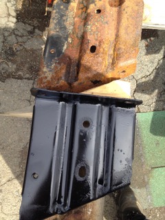

Well finely found my parts pics show old and reconditioned replacements cleaned up and three coats epoxy finished on the week end. Will install soon. Thank to everyone who tried with leads, I was able to find them off a low milage 2001 ST stored in a garage after the Transmission blow up. 105000 US Miles. Parts found in Canada salt country.

Can't see the pics as posted... but glad you found the pieces you needed.

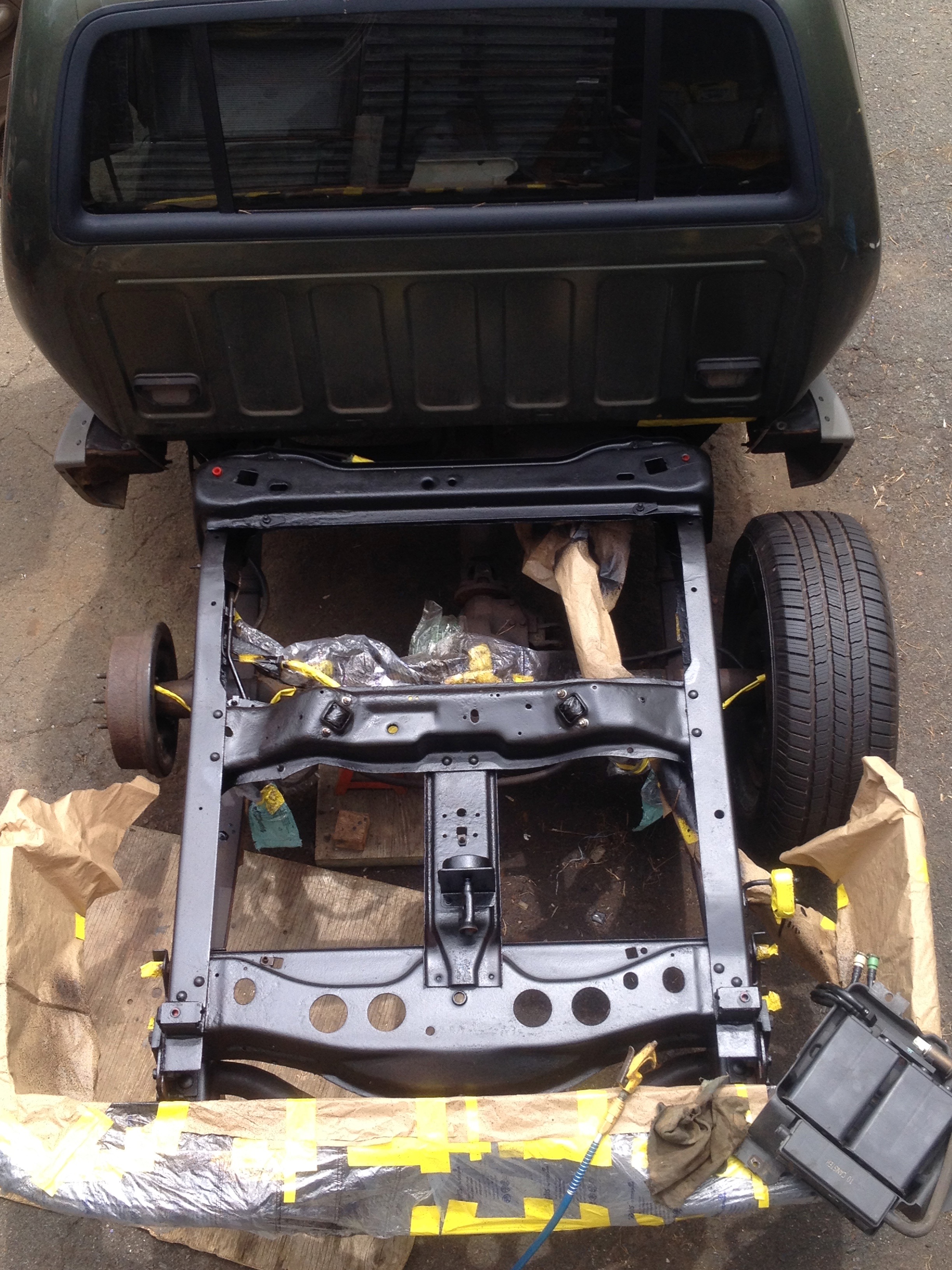

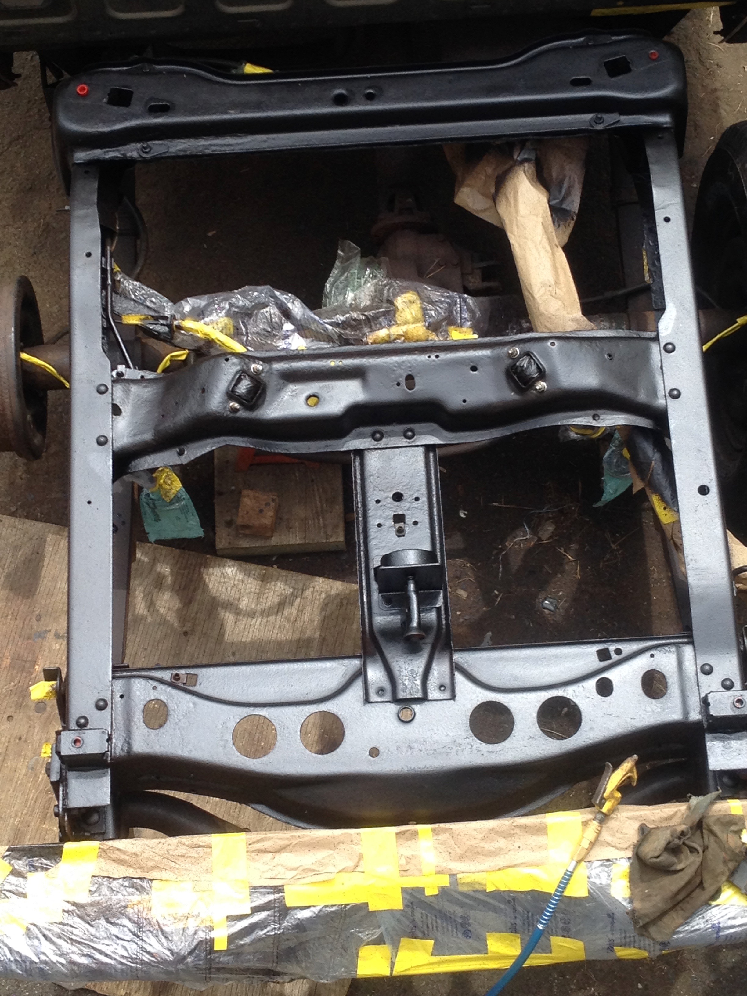

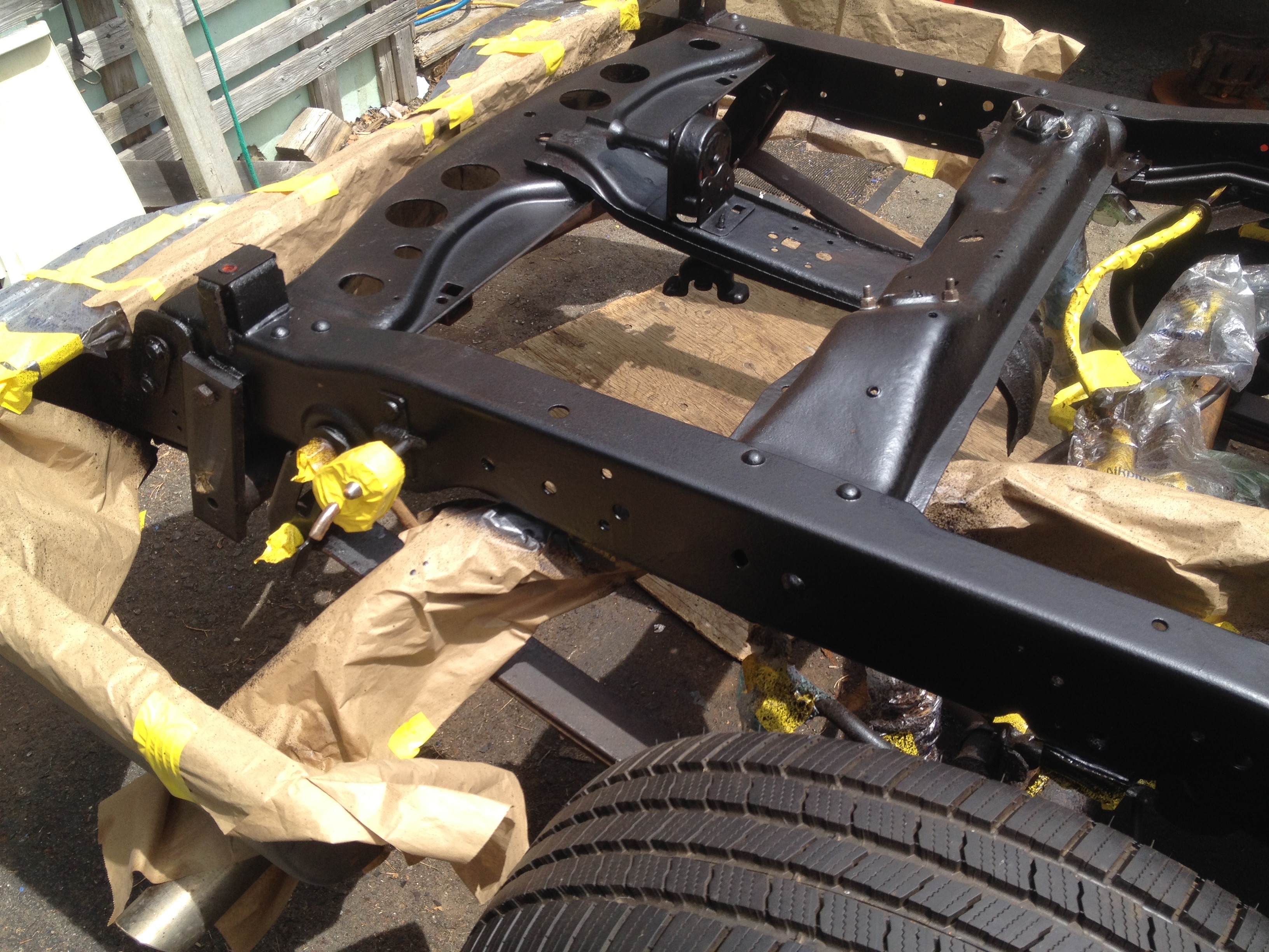

Well it took over 6 months on and off but the old girl has been back on the road for about 40 days. I replaced the gussets & reinforcing brackets along with all the metal parts of the body mounts, both frame and cab while we were at it. Body mounts were replaced 2 years ago. Then I cleaned the frame, repaired all flaws and rust proofed it. Reinforced the frame to eliminate as much torque twist as I could. Also complete overhaul of the fuel system, cooling system (no Plastic), emission system, drive train, brakes, steering, suspension, heating, air and electrical. Replacing all relays, controls, valves, lines. rubber, wiring harness etc and all body corrosion. She is running like a top, and is tight handling the corners, bumps ruts, on and off the highway. All components are running within specifications. The only thing I will need to do is rebuild the engine and transmission which I have acquired and am doing now for future use, {when the originals cave in.} She will out live me and go on to serve my grandson for many years. Its been a fun LAST project for me even with all the frustration of looking for parts etc. And with all the work over the last 3 years she is better to-day than the day she left Louisville in 20.09.2000.

Nice job. It looks great.
Good job, I'm very jealous of all your hard work.

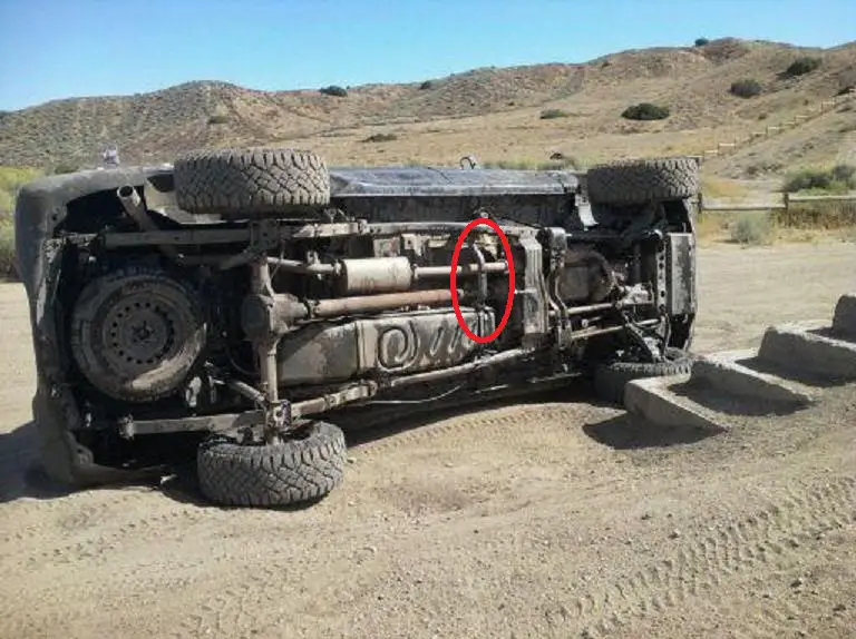

I finally did something about the low hanging part of the middle welded-in crossmember. I've hit it a few times and it seems to be first place I hit when rock crawling. Must be 2 1/2" below the frame? Since I have a 3" body lift and the exhaust is tucked up a bit, there was room to cut off the low part of the crossmember* and weld in some bar straight across and gain a couple inches of clearance. Almost up to the bottom of the frame.
*I added most of the reinforcement before I cut it off the important bits.
I didn't take a pic of mine, but here is a nice view of dan_ill's truck posing on it's side from back in 2011, and the crossmember is circled.

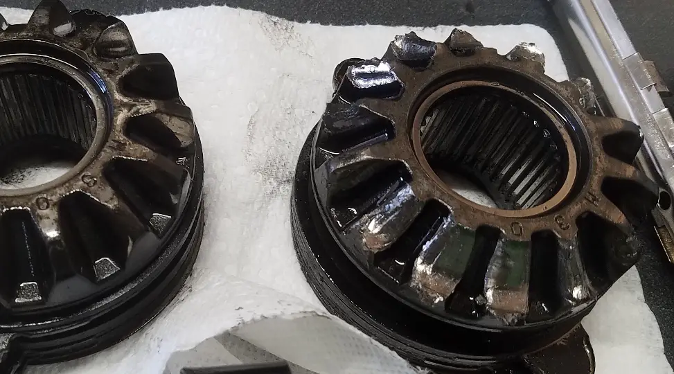

Went wheeling last weekend and broke rear diff spider gears on some rough boulders. Had to trailer it home.
Finished up replacing them today and put in new LS clutch plates while I was in there. Not too bad of a job, just went slow and watched lotta youtubes.
