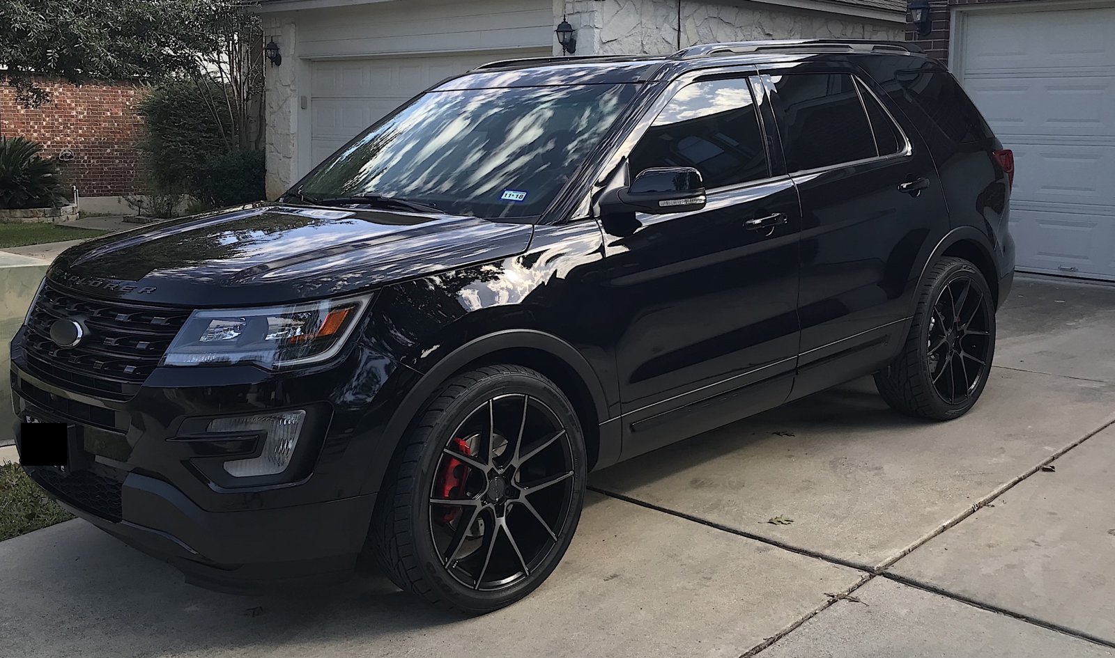

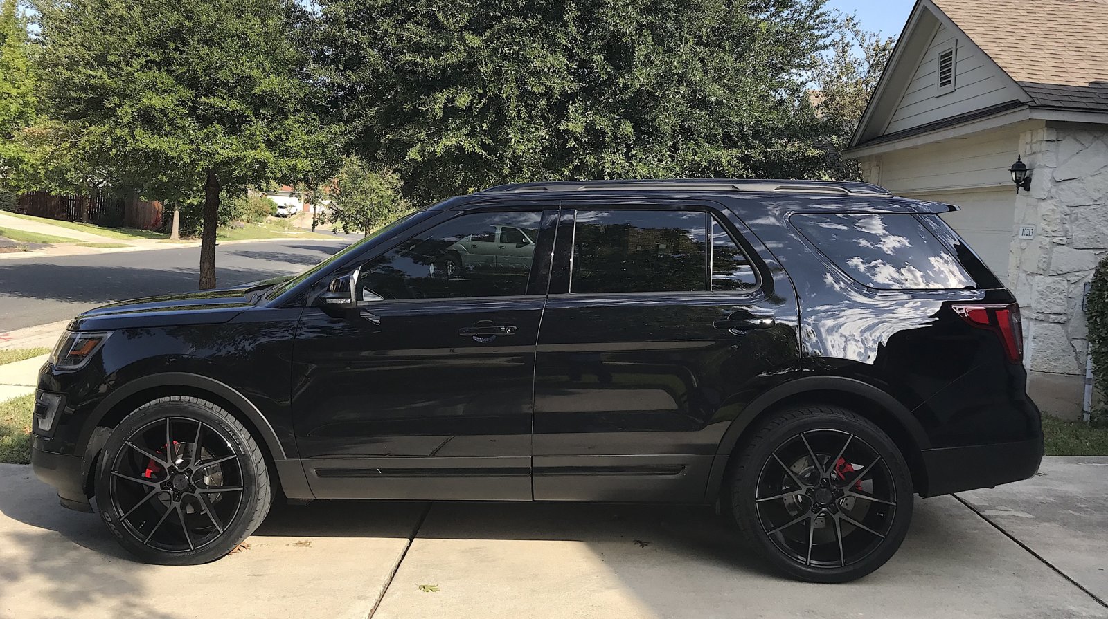

Hello, Just wanted to introduce myself. First time posting, but long time reading this site. I've learned a lot from all the interesting posts here and gotten really cool ideas for my Explorer.
I have a 2016 Explorer Sport. I've done a bit of customizing on it
22 Rims and Tires
Brake Discs and Calipers
LED interior lights
Blacked out Ford logos
I hope to keep improving my Explorer and learn from you guys and gals
Thanks

Really like your choice of wheels......I'm big on the all blacked out look.

Now you gotta blackout the chrome exhaust tips.

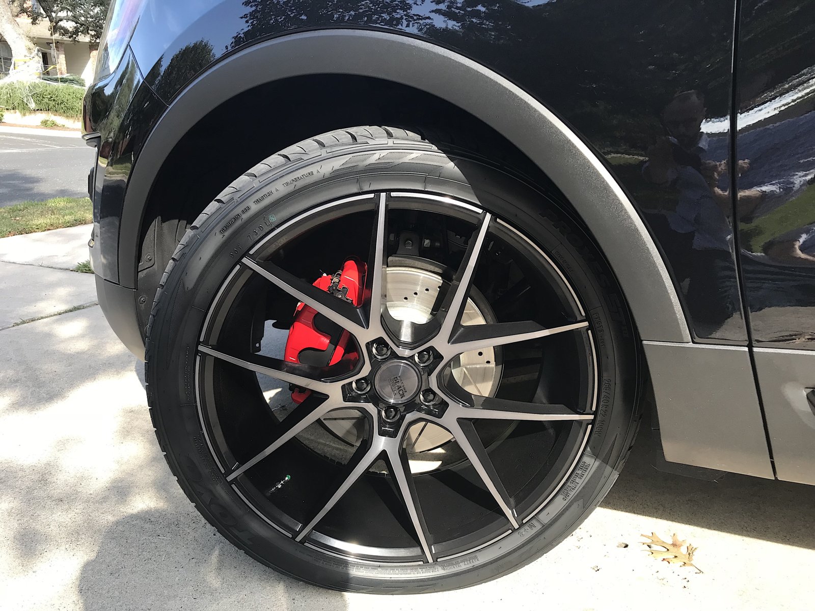

Finally had time to have my Powerstop Brake Kit installed over the weekend. Although you can likely buy as a kit now, I purchased the items separately as they came available. After waiting for MONTHS and much hounding, Powerstop finally released to their retailers the red powder coated calipers for the xSport that I've been after. Rockauto.com were the first to carry them (keep your old calipers as cores if you order through them). I ordered the pads and rotors through Amazon.com. Because my wheels are a PITA to keep clean I went with their low dust pads, but they have many higher performance options to choose from. For me, the best part of the kit were the drilled/ slotted rotors and red powdercoated calipers. This kit was largely an aesthetic thing for me as my wheels show lots of the brake system. The braking on my 16 xSport was never poor to begin with- is there a huge difference if braking performance now? Not yet- I think the pads & rotors are still seating in and there are higher performance pads to be had, so no- but it is certainly equal to if not slightly better than stock. The rotors are anodized silver, which went perfect with my aluminum wheels as well. My wheels are 22x9's so there is a larger gap between the rotors/calipers and the inner diameter of the wheels than you can expect if you are running the factory 18's or 20's. This is NOT a "big brake kit", this is simply an upgraded factory replacement if you will. All of the dimensions are the same as factory. Cost wise, it is much more affordable than a true big brake kit. As far as Powerstop quality/ performance/ longevity, all I can say is that I had a Powerstop kit installed on my 07 Toyota FJ Cruiser for years and loved it (huge upgrade in braking). The Powerstop website will help you answer any questions you might have and their email customer support is very responsive. Cheers.

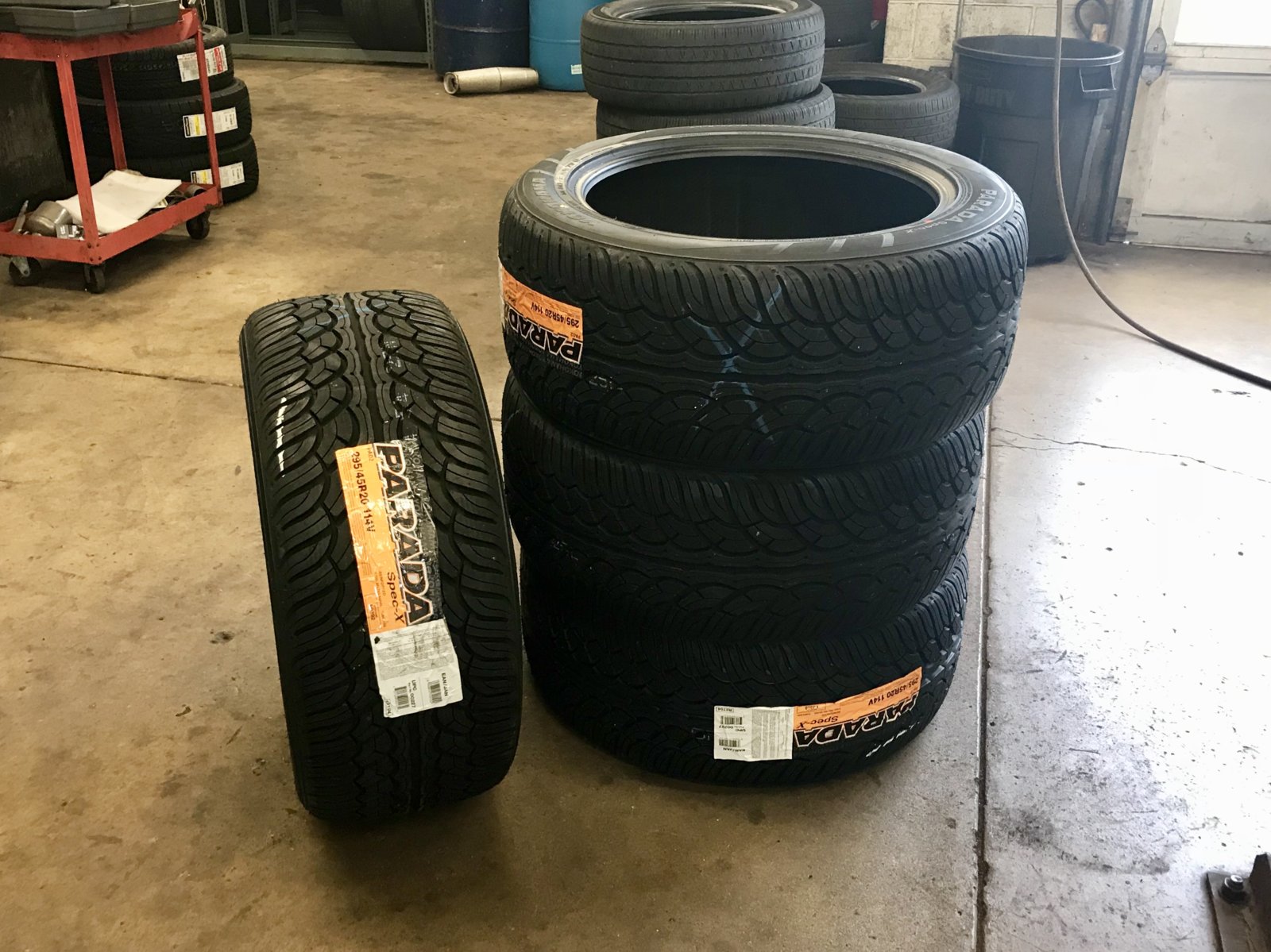

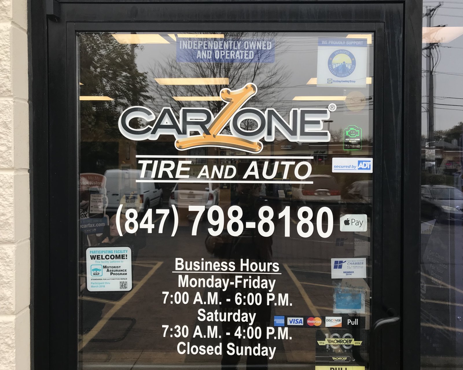

Putting some new shoes on the rig with the best guys in the business. Got 30K on the Yokahama Parada SpecX tires.
I wanted to get the Pirelli’s but they were $500 per tire versus $185. Couldnt actually justify spending that much on tires do you believe that?

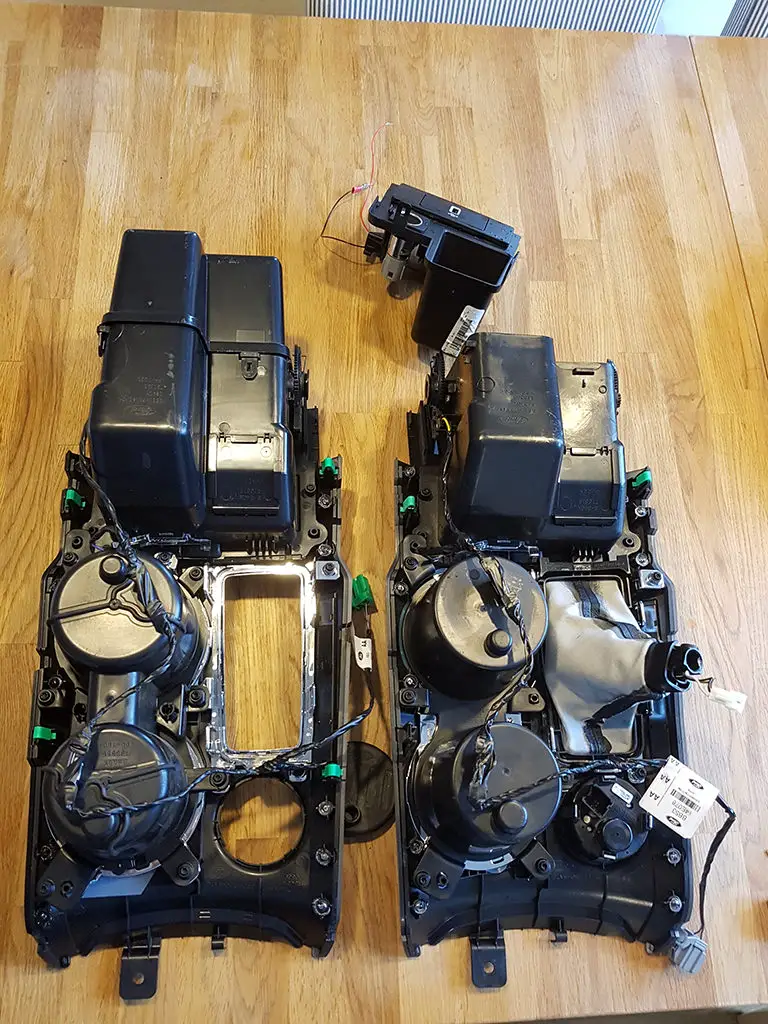

I posted this a while ago, wanting to put a 2016+ center console on a 2012 (better cup holders, the Sync3 USB port part actually clicks in, it's prettier...). I researched the heck out of it, comparing everything, and I just couldn't find any difference in them. In the end I decided to throw money on it and I got one from a wreck on Ebay (has a few scratches, but so did the old).
First, I took out the old console. There's an that helps where the guy rips apart the whole center console, but it's pretty easy getting just the top part off. The "hard" part is the 2 screws holding the shifter (hard because of limited working space).
Here's a comparison of the consoles, at first glance there's really nothing different about them apart from cupholders (ignore that I've already taken the back off the right one). On the right is the old (2012), on the left is the new (2016+)

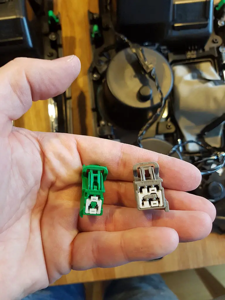

On closer inspection, I did find something different, which would normally be a big deal (gray one is old 2012 one, green is new 2016+ one, this is the harness connector that connects down to the car)...
However, the entire harness is actually exactly the same in every way, except for that connector. So I took the old harness off and moved it to the new console.

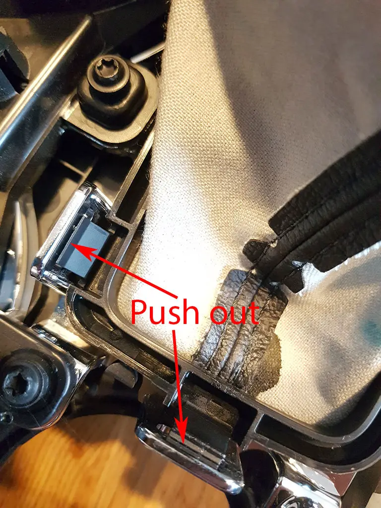

To move the shifter over to the new console, you unclip it from the console as so:
.. on all sides, then click it in on the new console. The dial for drive modes is the same concept, it has 4 things that you push in and push it out, then click it in on the other.

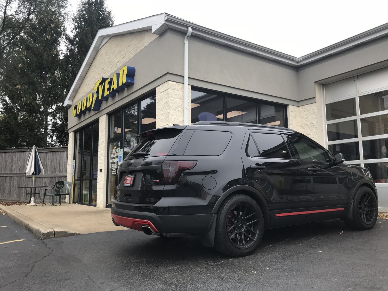

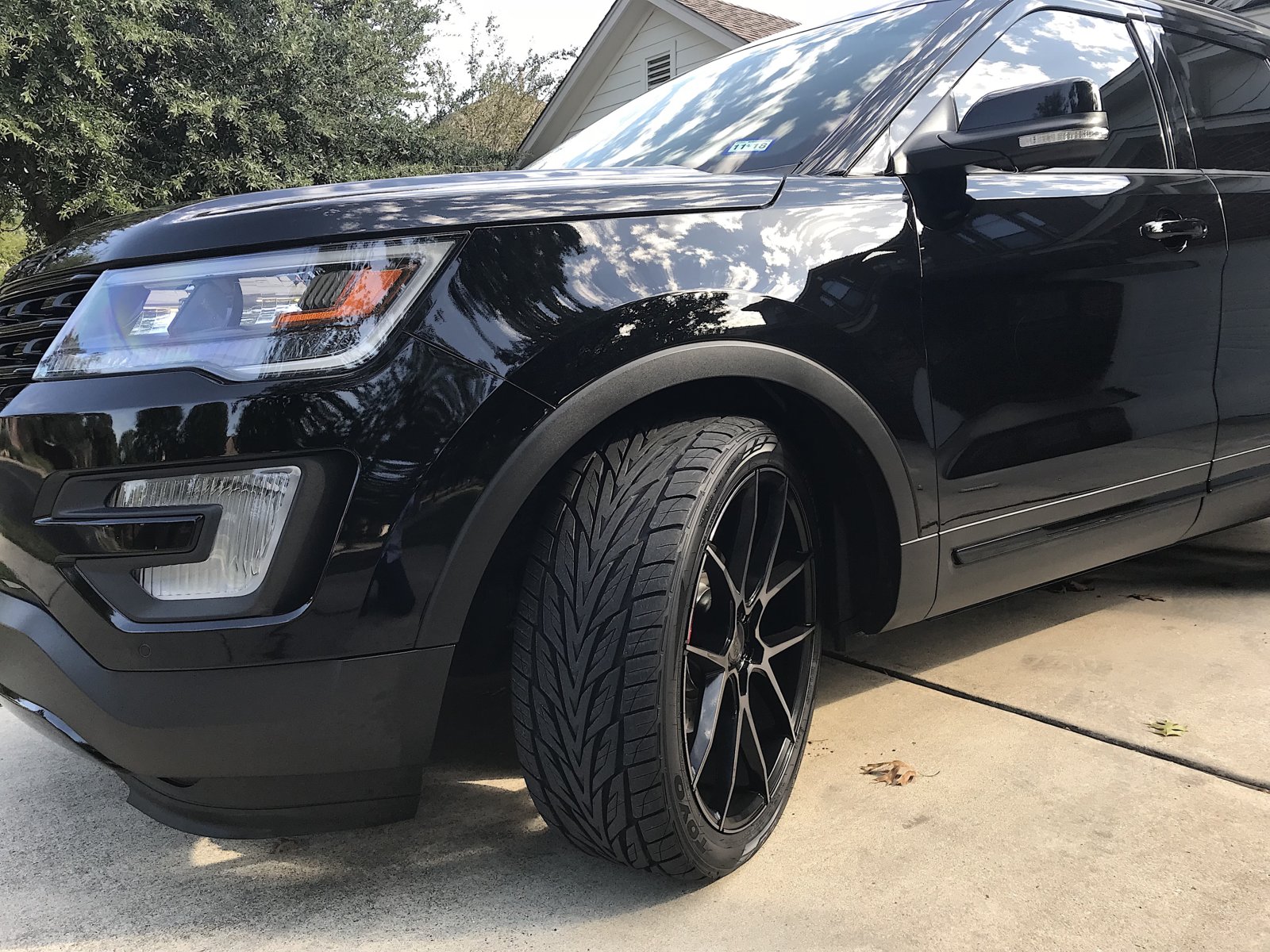

What size wheels are you running? Are you lowered? Spacers?
Wheels: Velgen VMB6 20"x10.5" with 45mm off-set
Tires: Parada SpecX 295/45R20
Suspension: H&R Lowering Springs (2 camber bolts used for the back)
Fits perfect in the wheel well. This was @ken60631 original set up. Thanks for his inspiration.
Looks great. Thanks for the info. Its my next move for sure. Just wasnt sure if I needed the spacers any longer.
