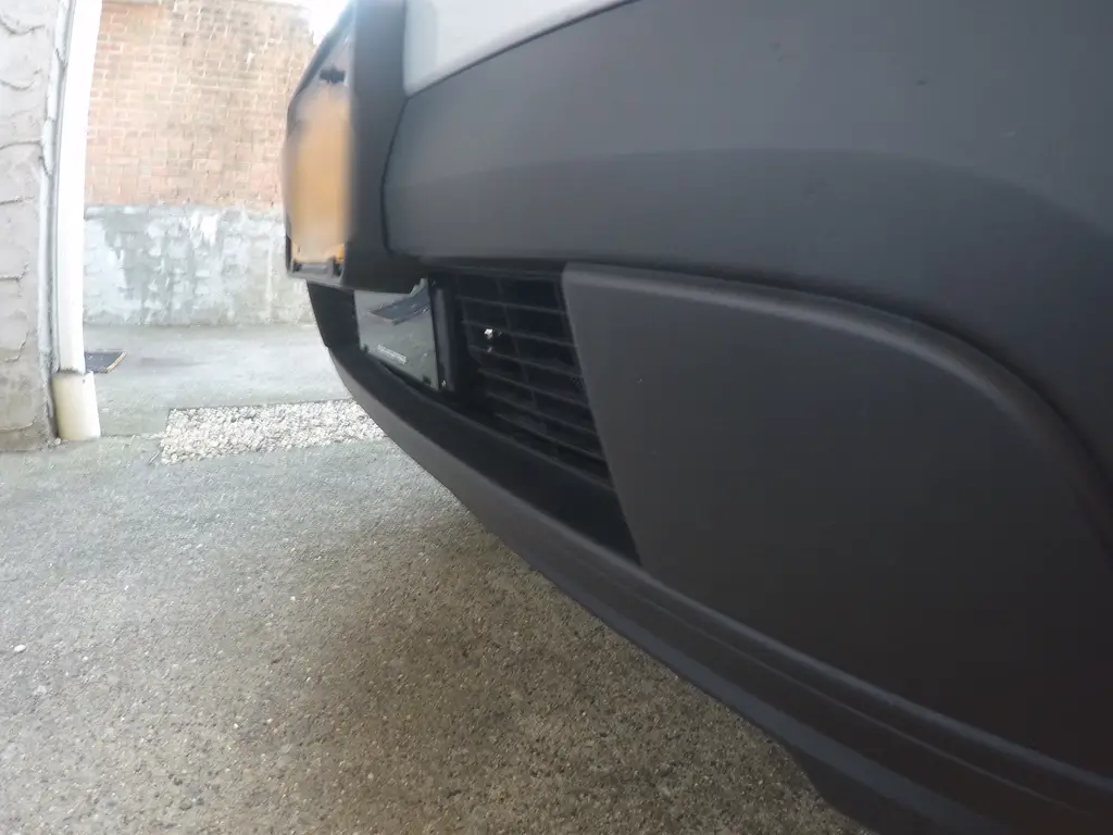

So I just put a lightbar in behind my grille. It was actually fairly easy despite how the photos look!!! I know that it looks very hard, but these fords are fairly easy to work on!!! It's a cheapo depot light from amazon that is $79. I bought the "spot" version just as the application site would make the fog version almost impossible. The light bracket is from Offroad Alliance ( Crown Offroad Auxiliary Switch Panel ) and I LOVE IT! I ran the wires up behind the bumper support where the stock fog light wiring harness is currently. I will have more photos of the placement of the fuse block location, how I tied it all together etc, soon.

I did this a couple of months of months a go. I agonized over where to mount it. Wanted to mount it as high as possible, within the grille of course as I'm going for stock look anyway. And I wanted it completely outside of any airways. Couldn't bring myself to cut an opening for it. It will not have a good finish I knew it. I ended up mounting it as the photo but I opened another air passage in the plastic exactly above that. So airflow is almost unchanged. Works pretty well in the deserts and in dark storehouses districts where I have to be often.

For my 2011, I run a 20" light bar on the bottom grill in the middle of the fog lights (grill removed). Depending on the light bar you get, you can mount it with the pre-existing screw taps on the bottom of the metal bumper and you don't need to drill anything. My light bar had slider mounts on it, so I mounted it and slid it over to center it. I have no issue with airflow. Also, since its just a 20 inch, and doesn't draw much amps, I connected directly with my fog lights so it comes on with my fog light switch.
