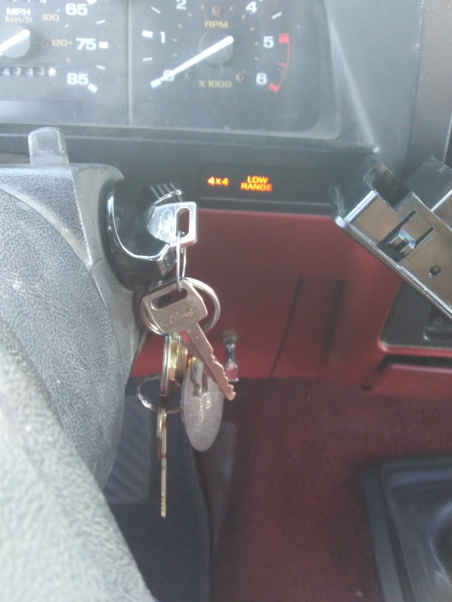

Got my 4 wheel drive working again with a nicer 94 style push button I also had to change out some bulbs in her to because wonderful rear abs light went out while out to store. Also finally got my 4x4 dummy lights working correctly.

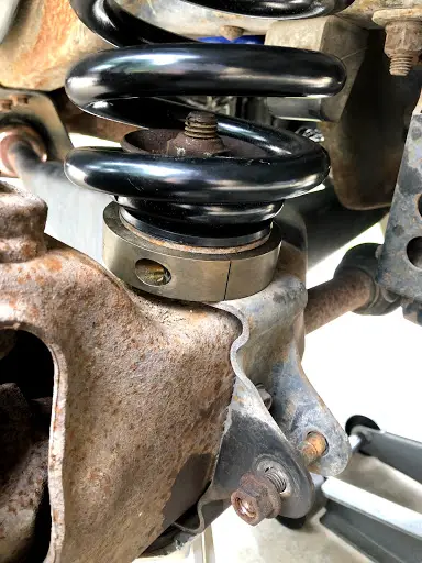

I rebuilt my front suspension this past weekend...
Went from this...
To this...
Replaced with new:
- front springs
- radius arm bushings
- shocks
- sway bar end link bushings
- rear shocks
Also installed a budget boost to help level the front end some (because of the heavy replacement bumper).
3/4" x 4" diameter solid brass rings (happened to have these laying around the garage - balance weights from some engine testing decades ago)
The suspension still needs to settle a bit and then a full alignment. But initial measurements said the springs and spacers raised the front up almost 2". Springs alone helped with the difference in sag from passenger to driver sides (almost 5/8").
Front shocks were completely shot and looked original. Rear shocks had definitely been replaced at some point. Radius arm bushings were bad and allowing a bit of metal-to-metal contact (although you could not hear it). Wasn't too bad getting the radius arm-to-axle beam bolts out. Total time was about 5 hrs, including a slight learning curve.
Those locking collars are a great idea
nice work everything looks great
Swapped in a manual transfer case and power sport seats last Saturday.
Those locking collars are a great idea nice work everything looks great
Thanks!
The brass collars were an "at-the-moment" kind of thing. I was going to use just regular washers, which I have, but they ended up with too small of an ID. Then I remembered the collars. I have 6 of them (well, 4 left). ID on the collars was 1.5" so that allows them to center on the spring stud pretty easily. Allen head cap screw bolts hold the two halves together, each from the opposite side (balance thing...).
They were from a 3.1L Chevy V6 engine that was being used for torque-loss testing way back in the early 90's (my part-time job during college). They were balance weights used to simulate the weight of pistons, rings, wrist-pins, rods while spinning just the crankshaft in the engine. In case anybody was wondering...

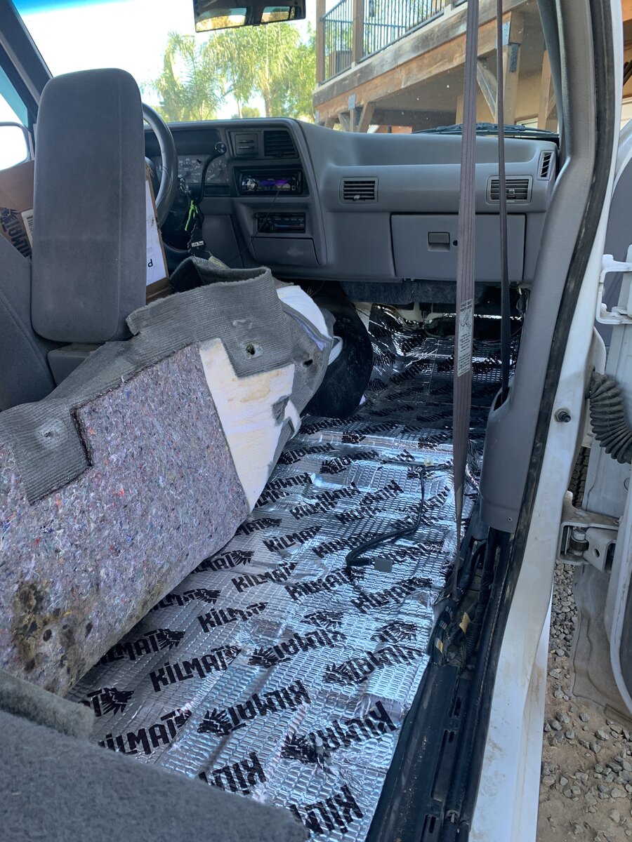

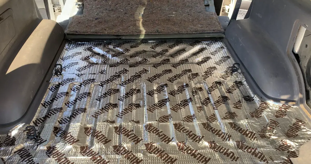

Sound Deadener!
I did the entire floor, cargo area and inside the rear quarters with Kilmat and Silles, both 50mil. It dropped the volume of road noise and the sound of my 35" Maxxis Razr's down about 50%. If you open the box and let it sit a few days the tar like smell goes away.

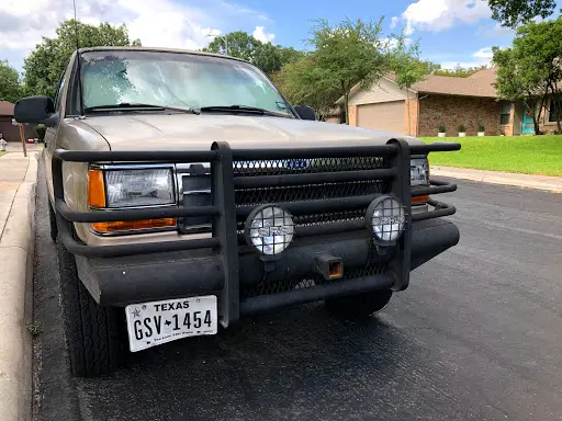

Replaced my old yellowing headlights this past weekend with some clean/clear ones from RockAuto. Made a pretty significant difference.
Also polished up my turn signal lenses and plastic chrome trim/grill while I had it all apart.
Old look on the left, new look on the right...
Funny how the only "nice and shiny" bits on the truck are hidden behind that big bumper!
FYI, I love this bumper, but it is a royal PITA to get the headlights out with it in place. The lower turn signal/trim will pop off like it's supposed to, but you can't pull it all the way out and off. So it sits in the way of the two outer-most bolts that hold the headlight housing in. Gives you only about 1.5" of room to get at those bolts. And no I won't sell the bumper to make it easier to get the lights out!
Such is my life...

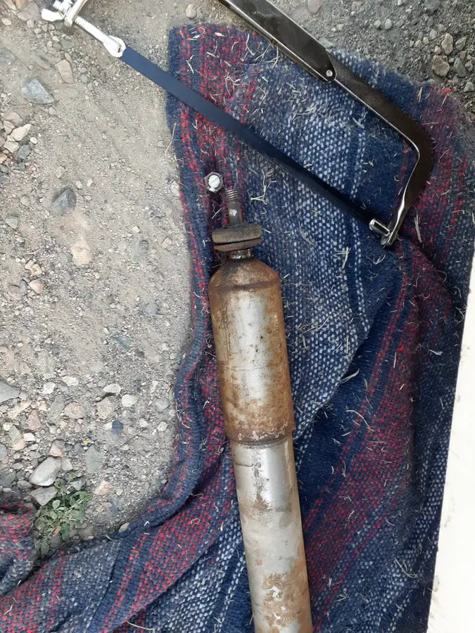

Replaced the front shocks ... Nut seized on the threads so I had to hacksaw it off, proud of myself.
I started to do the rear shocks, but the lower rear mount bolts are rusted to the inner sleeve of the current shocks. I ordered new mounting plates because I think that will be easier than trying to cut those bolts out, going to replace them with Grade 8's.
