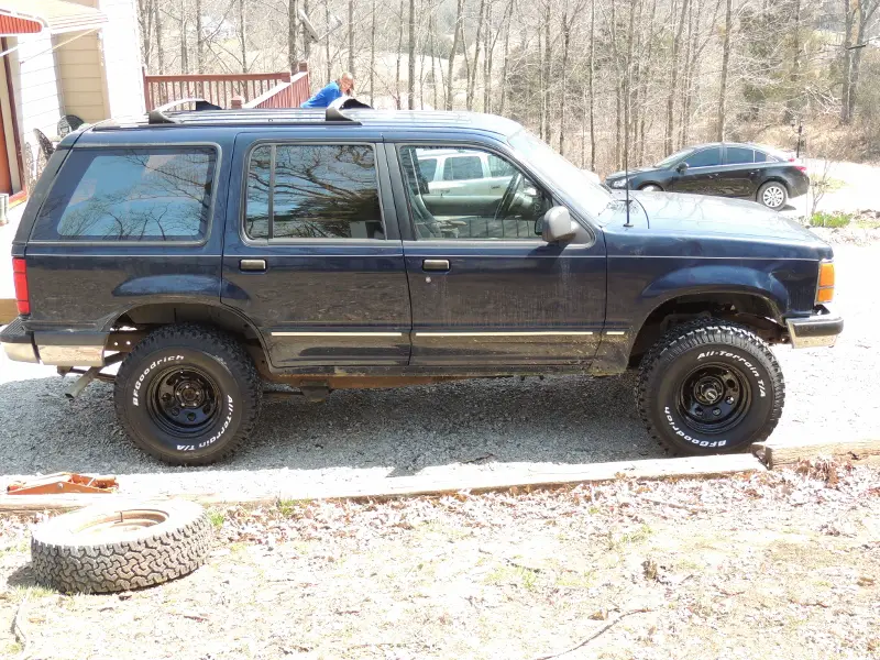

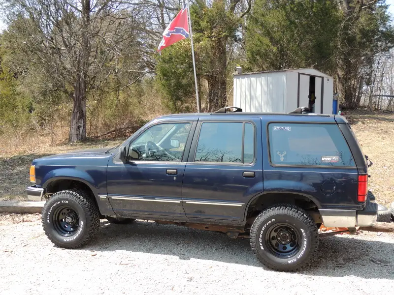

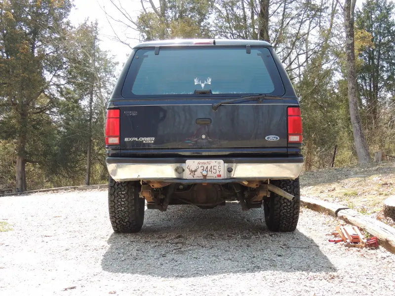

New wheels and tires. Still have to find centers. I noticed an issue the other day but I am not sure how big of an issue to make it. Looking at from the rear of the vehicle down the sides I noticed the driver's rear sticks out farther than the passenger's rear, as far as the tires go. Thought maybe the body had shifted, but according to my measurements of the body to the frame before I started they were correct. So I crawled underneath and measured the wheel distance from the frame and sure enough the driver's side is 1/2" farther out from the frame than the passenger's side. What to make of it....
